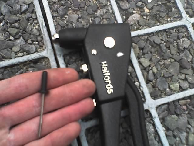

- rivet gun/rivets (i used original ford ones, available from ford for £6.54)

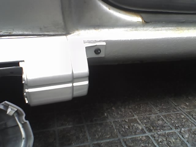

Its up to you how you do under the skirts.. either self tappers or rivets, i have not got round to the underside of mine yet but its not noticed and they dont hang down at all.

Ok removed tape/clamps this morning, this is the result...
