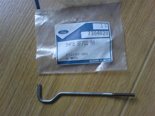

Rod assembly/clutch rel. = 7304020 (£2.71 as of July 2006)

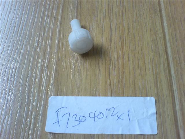

Screw special = 7304012 (£1.77 as of July 2006)

Clutch pedal = 7304014 (£25.52 as of July 2006)
Pawl/quadrant = 7346848 (£2.32 as of July 2006)

Dunno if this is anygood to anyone but just got all the parts through from ford so have taken a few pictures to help you when you come to buy them (mke sure they give you right bits lol)
7304014
7346848
7304020
7304012
7021871
.JPG)
7304014
7346848
7304020
7304012
7021871
