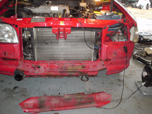

The piece of valance I had to saw away to fit the intercooler:
Cooler in place:
The small strip marked out to be trimmed (by Mark's very helpful dad while I scoffed a burger!) to accept the cooler:
The finished product:
