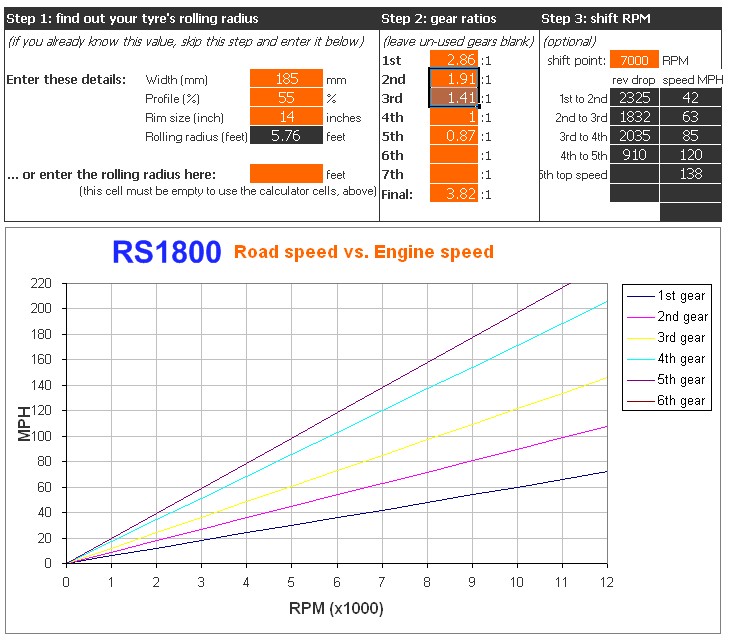

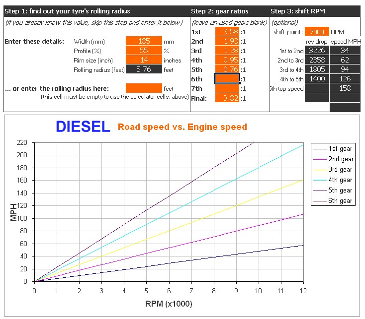

Anyone know these? I did a search but didn't turn up specific ratios
RS1800:
1st: 2.86:1
2nd: 1.91:1
3rd: 1.41:1
4th: 1.1:1
5th: 0.87:1
Final Drive: 3.82:1
Diesel
1st: ?
2nd: ?
3rd: ?
4th: ?
5th: ?
Final Drive: ?

Re: Info Request: Diesel Gearbox Ratios
Taken from Projects website
Car 1st 2nd 3rd 4th 5th 6th rev diff
Fiesta RS1800 mk3 2.86 1.91 1.41 1.10 0.87 n/a 3.46 3.82
Fiesta 1.8 diesel 89-95 gearset B 3.58 1.93 1.28 0.95 0.76 n/a 3.62 3.82
1st: 3.58
2nd: 1.93
3rd: 1.28
4th: 0.95
5th: 0.76
Final Drive: 3.82

Thanks, I requested RS1800 ratios before (you provided them along with a calculated top speed with the Diesel 'box), but not specific Diesel Ratios.

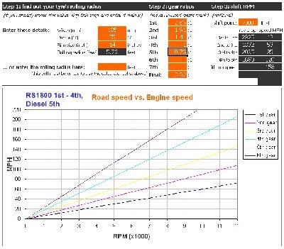

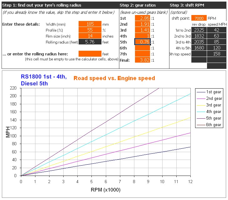

Thinking about this some more, the Diesel 5th in the RS1800 box would be better
Excursion :Thinking about this some more, the Diesel 5th in the RS1800 box would be better
That might be a easier solution
I like the diesel box for the economy aspect, 70mph at 3k instead of the RS1800 which does 70mph at 3.5k but would this make much difference in real life terms
The diesel seems to have a short first but I think the rest of the ratios could be lived with. Losing 9 mph low down should be offset by gaining 35mph with 3rd, 4th and 5th although I dont know what actual top speed you would hit with a 2.0 and the diesel box, theoretically it could go to 158mph but in practicallity you wouldnt see that with a standard engine

I think I will take this route, I can swap 5th gear in 15 minutes.

This graph looks much better.
RS1800 seems to have a stunted 5th to keep the 130 motor 'on cam', but I always thought the 130 1.8 was lacking in torque. I don't envisage the 2.0 will have any problem pulling an extra 770RPM cleanly going into 5th.

Excursion :This graph looks much better.
Does look to be the best option
