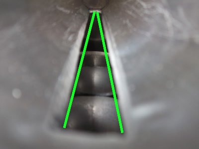

Excursion :Looking good mate. For more equal cylinder filling the entry into the main plenum from the feed plenum should be on a taper – starting out wide at the TB end and narrowing towards no 4
cheers. the plenum feeding the main plenum is a cone
- crazycage
- Posts: 934
- Joined: Sat Jun 23, 2007 2:24 pm
- Location: under my car
Re: fiesta st170 turbo
crazycage :Excursion :Looking good mate. For more equal cylinder filling the entry into the main plenum from the feed plenum should be on a taper – starting out wide at the TB end and narrowing towards no 4
cheers. the plenum feeding the main plenum is a conedidnt you see you pic of the cvh one i made ? its a few posts up .

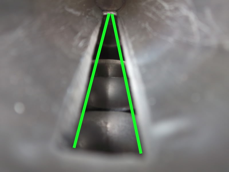

Like this mate
The area over each inlet port should be a 1/4 less than the previous port
Maybe the picture doesn't show the angle too well.

Excursion :crazycage :Excursion :Looking good mate. For more equal cylinder filling the entry into the main plenum from the feed plenum should be on a taper – starting out wide at the TB end and narrowing towards no 4
Like this mate
didnt know thats what you ment mate
the mountune wrc inlet that i have is a twin plenum like plenum i am building and the slot is the same size all the way along
the jenvey turbo inlet is very similar too.

The need for tapering down will certainly be lessened in a double plenum setup, compared to single plenum, but it's probably still there to a degree. I could've run a flow simulation if I had Solidworks to hand...best get to grips with simulation on Inventor!

heeman10 :The need for tapering down will certainly be lessened in a double plenum setup, compared to single plenum, but it's probably still there to a degree. I could've run a flow simulation if I had Solidworks to hand...best get to grips with simulation on Inventor!
a friend of mine does all the cfd for me ,but i am thinking of having a go myself ,just need to get it onto my comp
