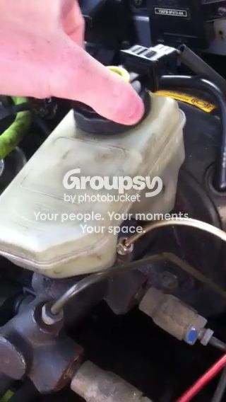

I took a quick video of how wobbly the reservoir bottle today but looking at your guide I can't work out Wich mc I have???? Anyone know??
http://i606.photobucket.com/albums/tt14 ... a9cd68.mp4
Also here you can see the state of my servo and just about make put the huge dent :o
Apologies for quality taken on my iphone

Re: Brake servo & master cylinder
Postby AW3K on Wed Oct 12, 2011 12:05 am
looks like a mk4 or 5 fiesta one
deffo not mk3 , the bar inside is prob wrong size, causung problems
shouldnt wobble like that
whats the pedal like?

Postby DanFraser on Wed Oct 12, 2011 12:07 am
That's just the reservoir bottle itself, I've been able to do that with every car I've opened the bonnet on, french, german, everything.
Bin the MC too, take EVERYTHING off the mondeo!
Postby russ-RST on Wed Oct 12, 2011 10:22 am
There is a tiny bit of resistance in the pedal but feels more like air and it goes down to the floor it does stop the car (although iv only tried this rolling it across the driveway) and it's not great at that neither :lol: right ok it does sort of make sense as it's a m reg 3.5 so is likely to have a few boys swapped over iirc so will the Mondeo servo still be ok? And will the pipes need changing? Also I have a tap and die set can I not re tap the tread on the end of the pipe to fit the servo??

Postby russ-RST on Wed Oct 12, 2011 10:26 am
DanFraser :That's just the reservoir bottle itself, I've been able to do that with every car I've opened the bonnet on, french, german, everything.
That was minimal effort if I push it with a little force the bottle almost lifts out of the m/c andyou see small bubbles come thru the fluid, it's defo had it lol
Ok so I want the servo mc and bottle and a bit of pipe with the connections on, and the cap if possible but I think my 1 fits :-? Anything else?
