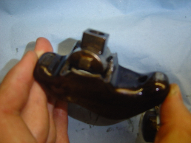

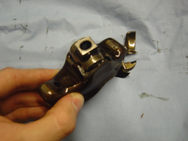

Just to update this, i finished repairing the car on Sunday, fished all the metal out, drained oil out and fished around in the sump using a flexi magnet to pick up any metal which may have gone down through the drain holed in the head. Put her all back together and the car is running sweet again.
Any way heres some pics of the mashed rocker :

Postby heeman10 on Tue Oct 17, 2006 3:02 pm
Bummer! Any chance of getting a set welded as S1 suggested and swapping them all over?
Tip: Taking photo's from a distance will make them clearer even though the the subject will be smaller. At least it'll be in focus that way :)
Postby black2 on Tue Oct 17, 2006 3:16 pm
I could weld some up myself, but ive just rplaced this one for now, whilst i had the rocker cover off i inspected the other seven for cracks, etc and they all seem ok, if it happens again i will remove them all chuck them in the bin, get eight off one of my spare cvh's, weld them and fit those!
