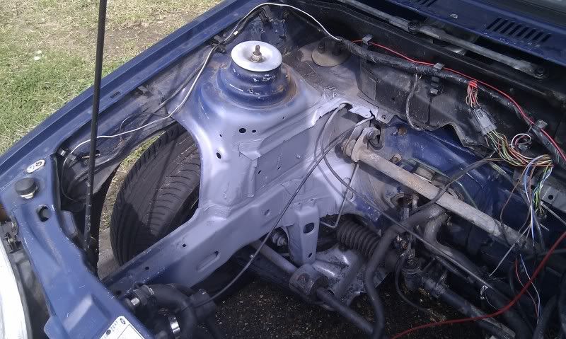

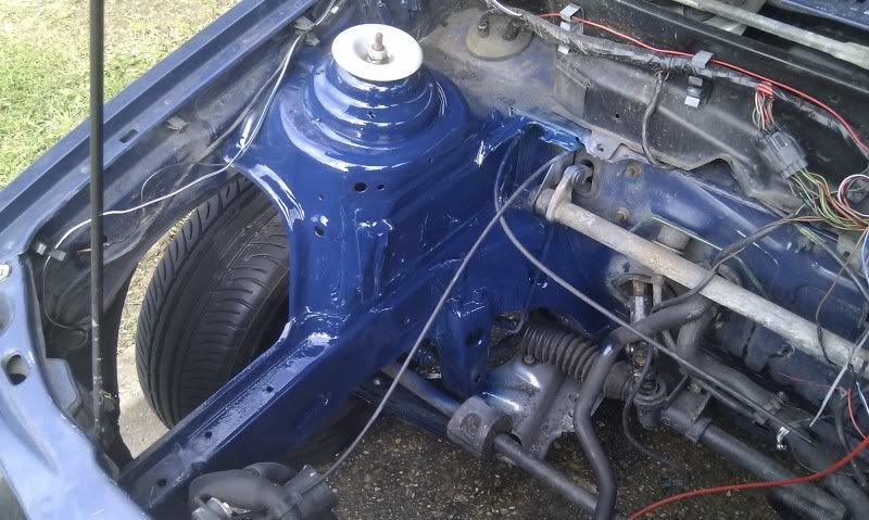

Gave the bay a quick clean and cut the old engine mounting area out today, and gave the area a lick of paint. It could do with grinding back a bit more tbh, but time is tight for fitp, the car may be tidied up a bit later in the year so can sort bay out then.

Re: 2.0 ST170 Bonus Dirtbox Sleeper - Update 20/3
Postby Rhinopower on Mon Mar 28, 2011 7:45 pm
Looks good in there! I think i will lift engine in tomorrow and then get my mount welded!
Postby jonyb4 on Mon Mar 28, 2011 8:37 pm
there used to be a mount there :)

~nomad~ :Image
Go on, do the lot 8)

I cant be arsed to take any more than that, my elbow aches from drilling 7 days a week :lol: Will at some point tho when i completely strip and repaint the shell.

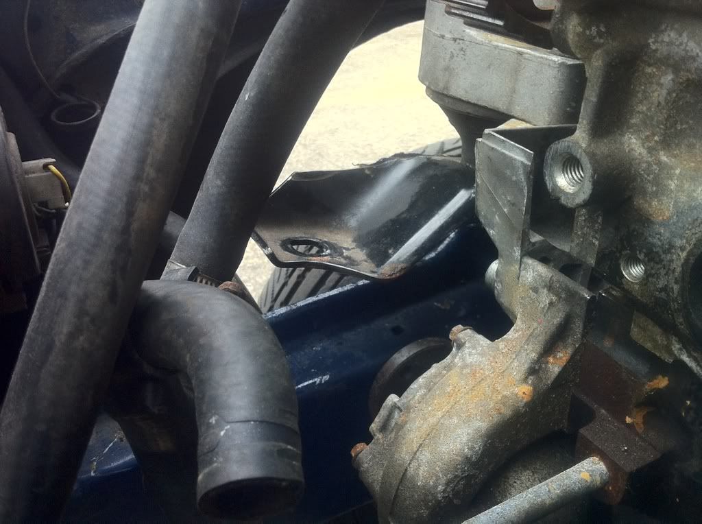

Do you think i would get away with rear alternator now?

Postby Excursion on Mon Mar 28, 2011 10:11 pm
Rhinopower :I cant be arsed to take any more than that, my elbow aches from drilling 7 days a week :lol: Will at some point tho when i completely strip and repaint the shell.
No mate, it fouls on the 'brakcet' going down from the chassis leg to the front bolt on the lower arm carrier.
Postby jonboisescort on Mon Mar 28, 2011 11:13 pm
looking good about the alternator ive put a rear mounted one on the escort
it sits quite high up
the mounts ive got are off a mondeo with a blacktop
Postby jonyb4 on Mon Mar 28, 2011 11:55 pm
gotta make sure the belt clears too mind you

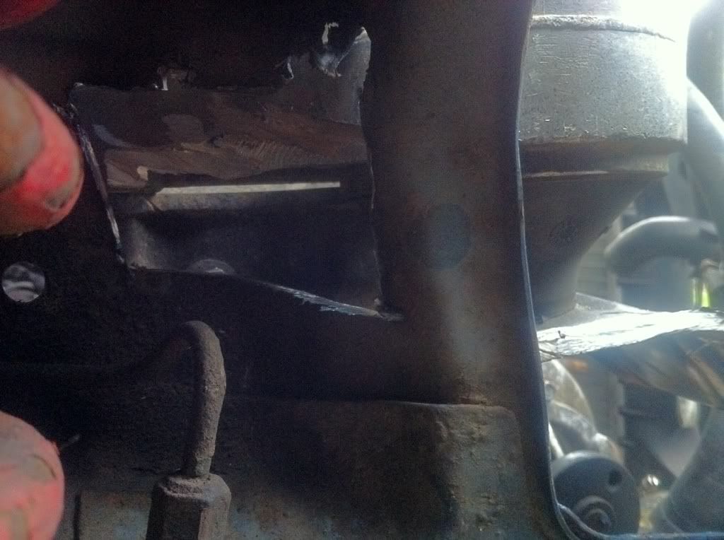

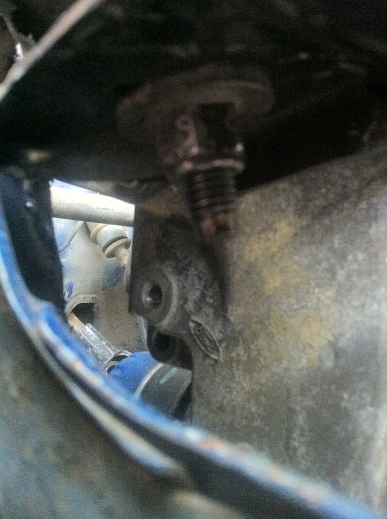

Postby Rhinopower on Tue Mar 29, 2011 9:38 am

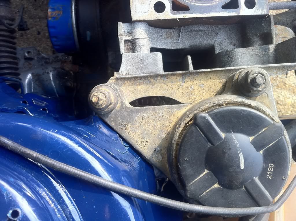

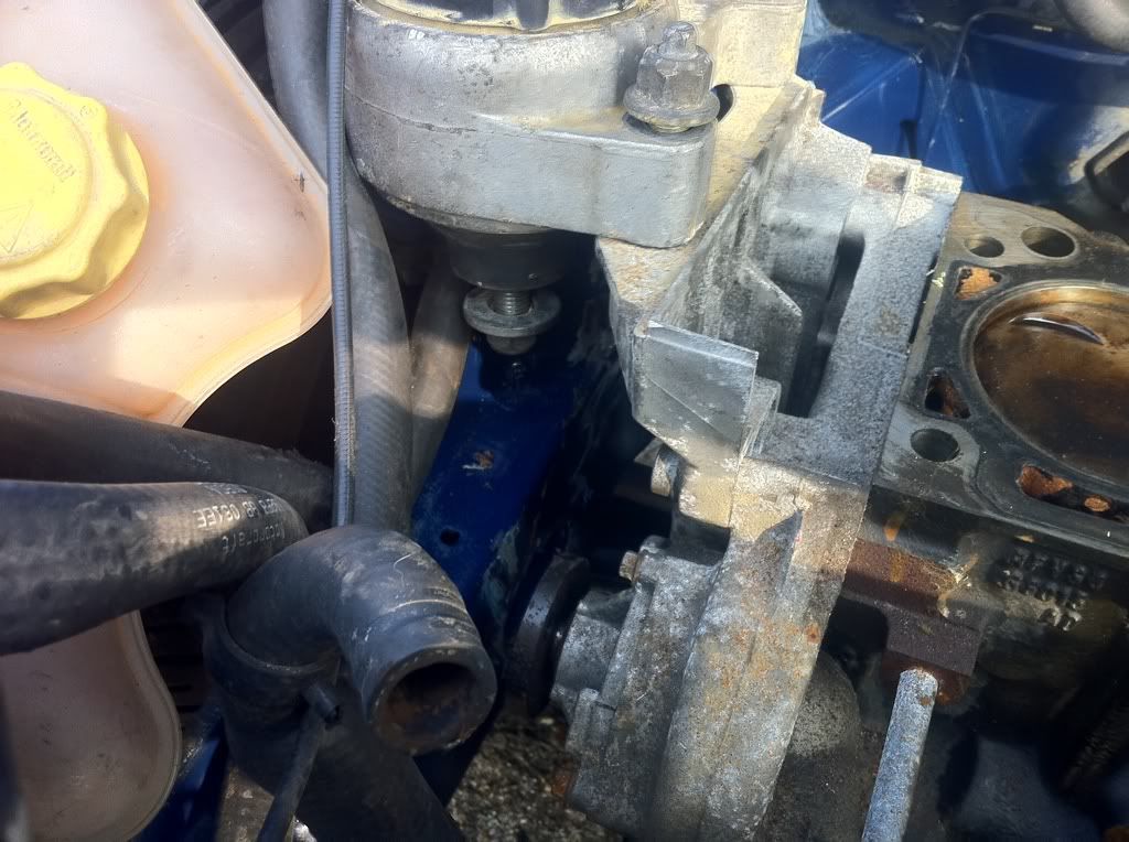

I had a spare 20 mins this morning so dropped the engine in.. As you do!
Mount is sitting pretty close to the wing (its touching)
The sump needs a bit more modifying, its currently resting on the CV so im going to chop a bit more of where it is, not lifting out again :lol:
And where the focus inner wing mount needs to be welded in

Postby ~nomad~ on Tue Mar 29, 2011 10:32 am
getting there, whens John coming to weld it?

Re: 2.0 ST170 Bonus Dirtbox Sleeper - Update 29/3
Postby jonyb4 on Wed Mar 30, 2011 1:03 am
so glad this aint me doing it, alot of work :(
will the mount bang and knock on that bracket?
Postby ~nomad~ on Wed Mar 30, 2011 1:45 am
I reckon so as it sits, not sure if Brian is planning to cut the last of old mounting down or take a bit off the bracket.
Postby jonyb4 on Wed Mar 30, 2011 2:23 am
a bit of both might even be needed?! :(
Postby ~nomad~ on Wed Mar 30, 2011 11:04 am
maybe, I think it will more rub than knock.

Postby Rhinopower on Sat Apr 02, 2011 7:08 pm

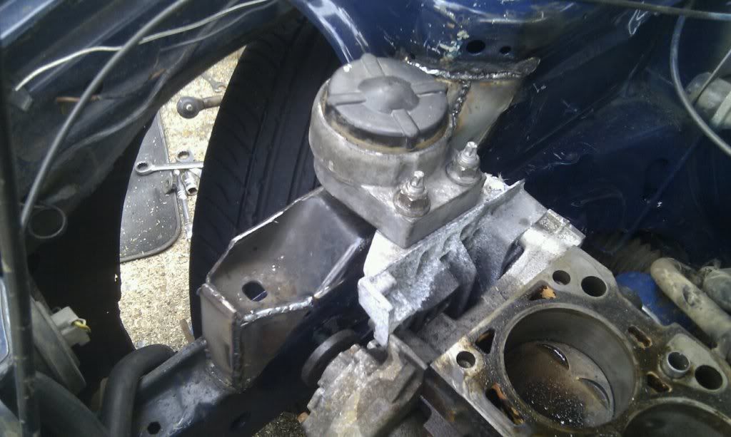

Little more update, started fiddling with the mount more. Ive got to hack a bit more out of the inner wing / strut and then plate it up to give clearance. Im also going to have to make a spacer to weld in from the front of the mount to the chassis leg, and cut a little triangle to go in at the back of the mount, sadly the angle grinder went up in smoke so i couldnt make up the rest of the bits ready for welding.

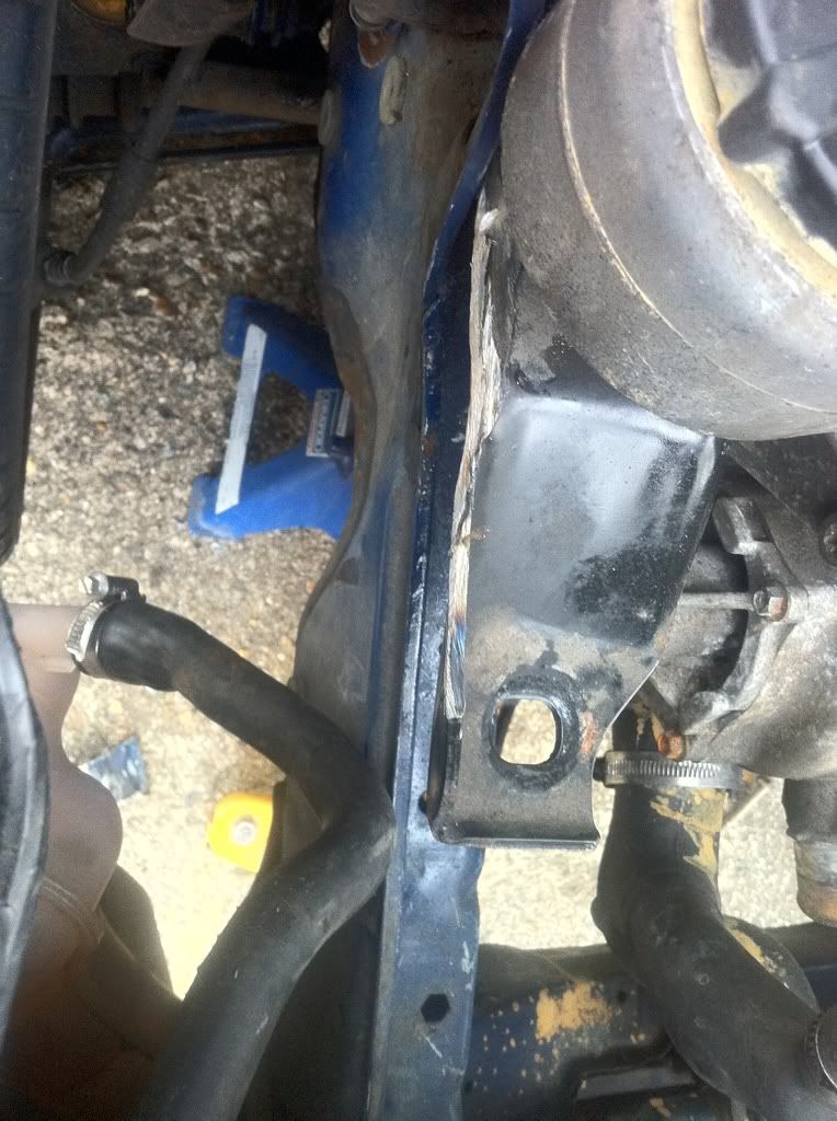

New mount all welded in, more pics to follow tomorrow, head is on, power steering rack is in (bulkhead needs modding to get the UJ through), and just need to find a few parts i've put away safely and cant find :rolleyes:

He had to do a little patch over where i had butchered before but its a nicer shape i think than the original. Cant take credit for the welding, was done by an old boy we use. Got the bit of st170 mount tacked in and then build the rest up with one rectangle bit and a few triangles for strength. Suprisingly good clearance for working on the cambelt side of the engine.

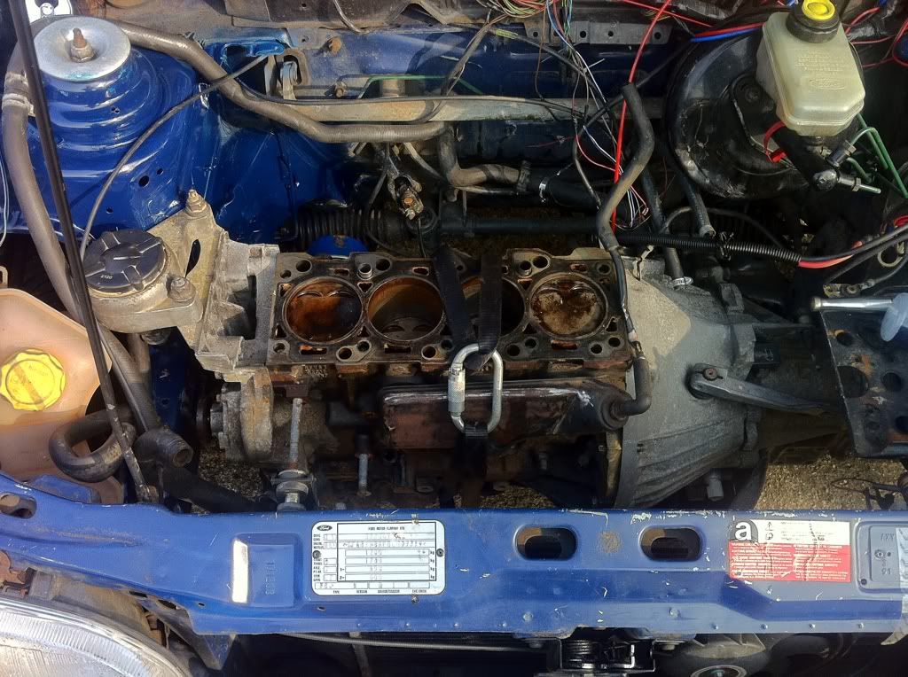

Postby Rhinopower on Sun May 01, 2011 7:41 am

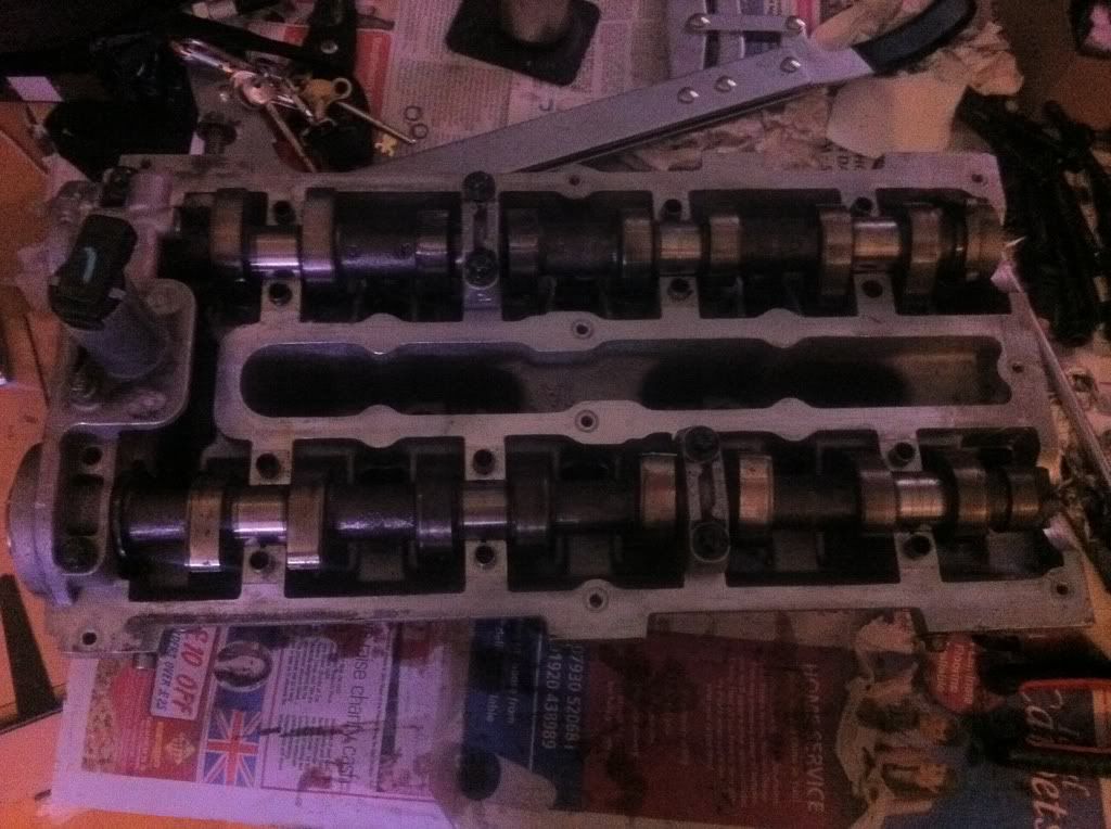

Replacement head is built up, the missing cam bearing wasn't replaceable and not to be found :(
I've lapped in all 16 valves, just need to check the clearance if the litters now, and return the valve spring compressor to halfords!

Re: 2.0 ST170 Bonus Dirtbox Sleeper - Update21/4 - Engine fitted
Postby Excursion on Sun May 01, 2011 1:58 pm
What cam bearing is missing, Ryan?
Did you steal that tool? :o
