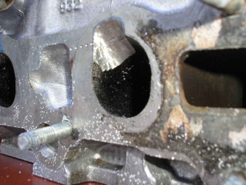

Since my ZT project moving too slow I decided to put Megasquirt, turbo, intercooler, ect. that I have on my current engine 1 400 cc CVH CFi.

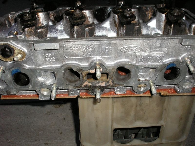

Haynes says that C/R is 8,5:1 and we measure head just to confirm.
Started the day like this:
And finished like this:
Head need some work to align EFi manifold, but ERST exhaust manifold fits (like T3 conversion on FRST).
Still don't have correct fuel pump but I have LPG conversion previously fited and will use it untill my pump arrive.

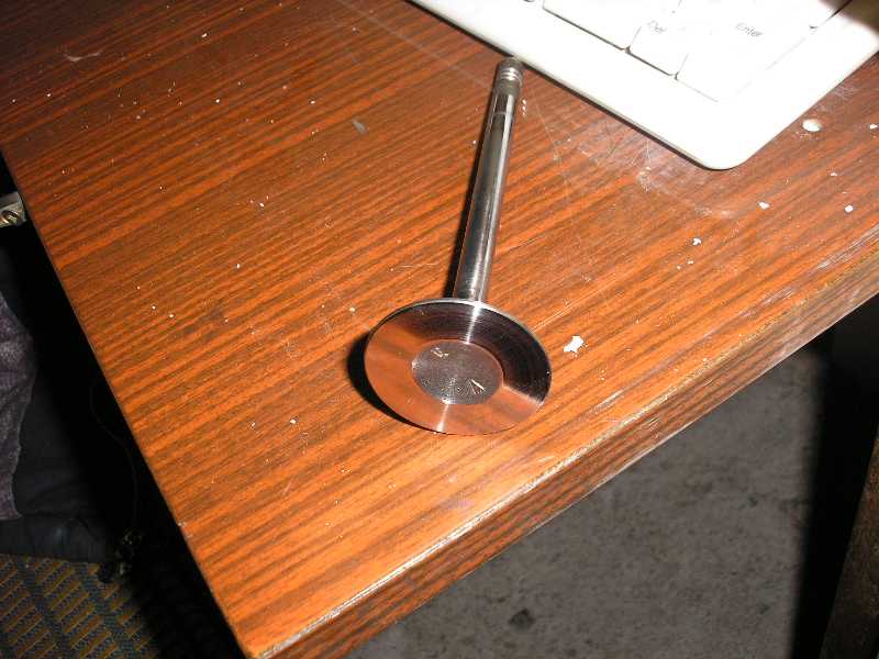

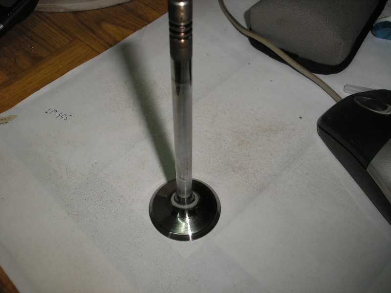

Not much work done today - just few valve seats are regrounded and valves are cleaned. Inlet valves are slightly polished.

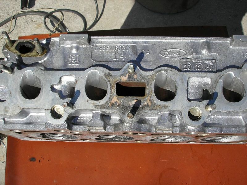

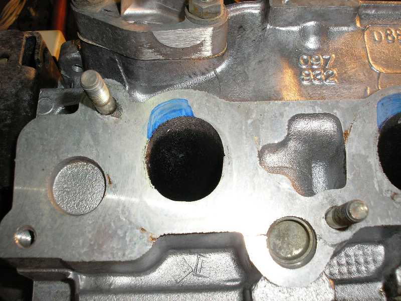

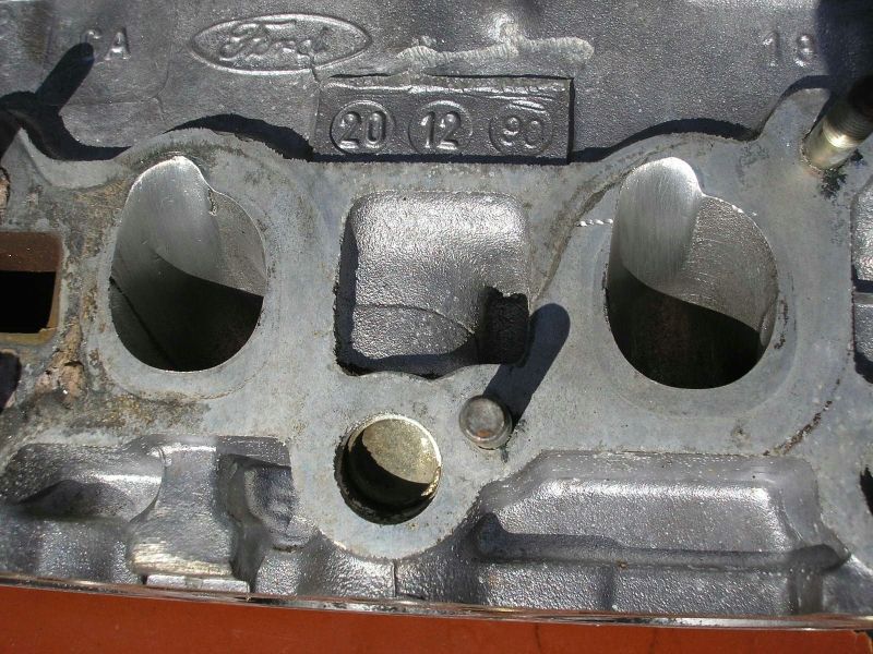

Head is rebuild - valves seat are regrounded, new oil seals. And head is modifed for EFi inlet maniofld :)
Hopefully engine will start tommorow if I sort my turbo watercooling (take a look at my post in General Discussion).

Еxcept modding of head to align EFi inlet manifold no other changes needed.

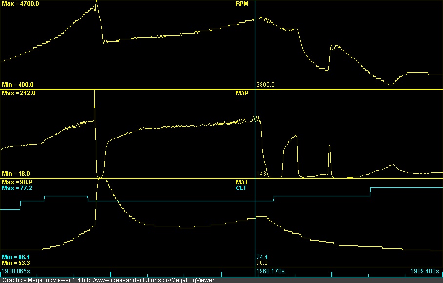

Last night I got my Megasquirt and engine harnes sorted, so I got couple of logs. Megasquirt control just ignition for now (based on engine RPM, MAT, CLT and MAP), that's why I didn't connect my TPS yet.
Running car without downpipe is fun :D , but that mean I can't use my wideband lambda sensor so see what AFR's we use... Downpipe is next thing to do!
Here is a screenshot of datalog of last night, showing only RPM, MAP, MAT and CLT:
Click on next link to download full Log and Logviewer:
>>>Click!<<<
