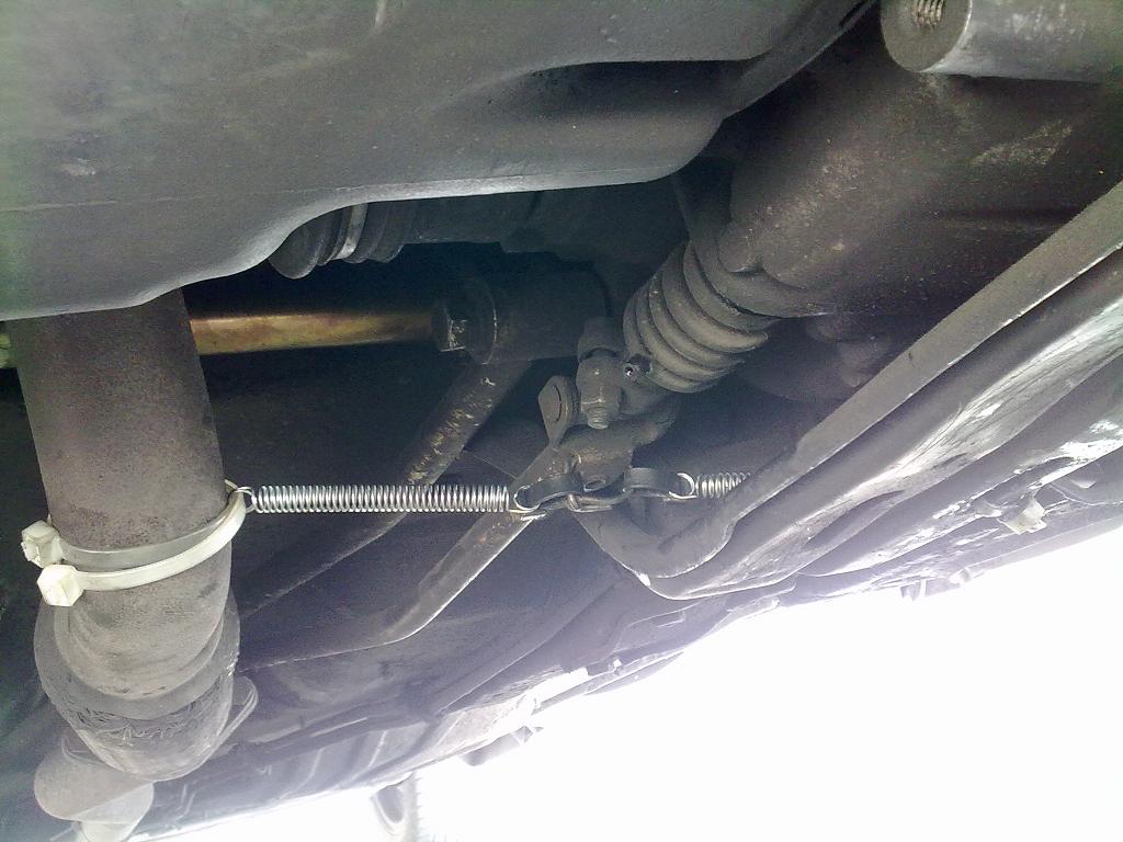

Re: Re-building my gear linkage (sort of guide)
was going to remove and rebuild my gear linkage but found a better solution and was done in about 15mins
connected the spring with 2 tick cable ties because the silencer gets hot, if it smelts i will replace it with some copper wire or something metal.
