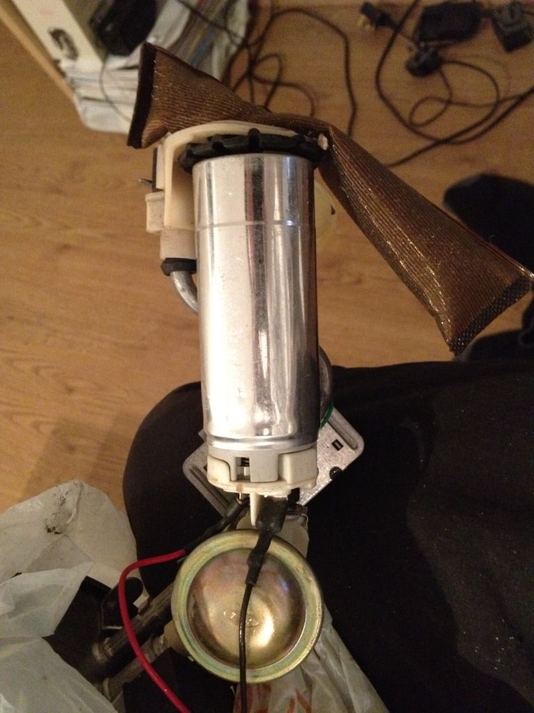

Re: my fiesta rs turbo(fast ford featured)
here u go jay, nothing stampted on it, no ford logo ect
the car has gone through 2 mapping sessions 1 on a rolling road and another on the road as a live map, and no comments were made that there is any issue with it
- pauldolman
- Posts: 831
- Joined: Mon Feb 24, 2003 12:08 am
what power you running though? the std pump is good for 180bhp.
looks std still, but without any part numbers who knows, but if you have been using it without any fuel issues, then carry on with it, or if your feeling flush, buy a new uprated one and keep that one wrapped up as a spare
ah well, if its a std pump its doing fcuking well
but i cant see it being a std one at that power.
i assume a std escort cos pump as fitted by ford would look the same as a std FRST pump, again, as it was fitted by ford, its normaly the pattern part ones that show the biggest difference as my pics, so maybe, and this is a guess as i have never seen a std ford fitted escort cos pump, maybe what you have is a std ford fitment escort cosworth pump? as the uprated frst pump is only a std escort cos pump anyway

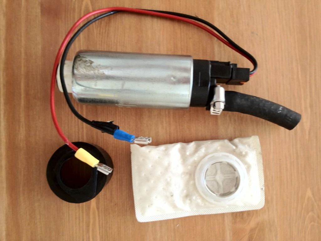

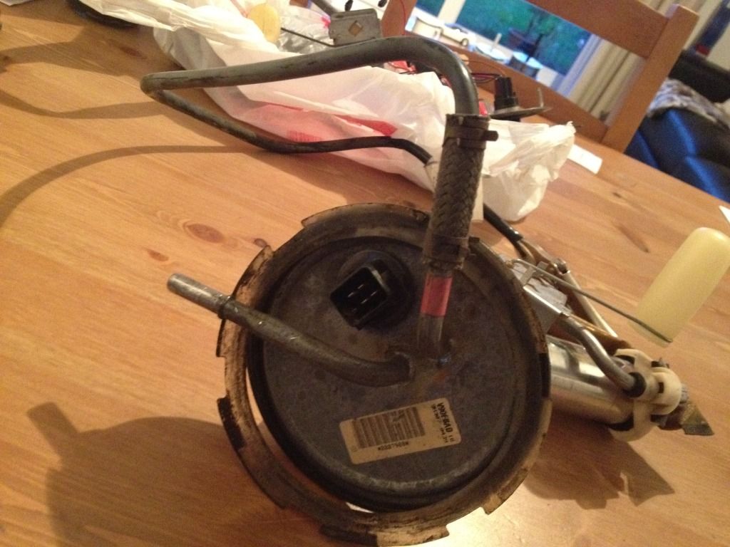

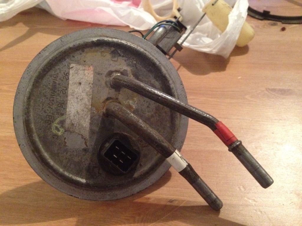

jay, jon or anyone else HELP needed, i'm getting more and more confused about fuel pumps
i've been down to see jano today for some general advise about the fuel pump issue, he was'nt sure what my pump was from eirther he said it looks very simular to a standerd fiesta pump but it might also be a small turbo esc [ERRR] one too, i'm really not sure what to do about changing it or not, it makes sence to change it as the tank is off IF it is a standerd one, but no one can tell me clearly one way or the other if it is a standerd one or not, i would have thought it is a upgrade of some sort but it's not something i've ever changed so i really don't know what to do
i suggested to jano about getting one of the sytec upgrade pumps but he was'nt that convinced on them he said what i really need is a bosch 023(gen esc [ERRR] pump) but it's not as simple as a striaght swap because it's so much deeper it would need to have a hole drilled in the top casing of the sender assembly and having a high pressure fixing and a new braided fuel line run to the fuel rail which will be very expensive
also the fuel lines pipes on the top replacment sender are at very different angles than my existing one(see pic below) should this still fit???????????, or can the sender parts be swapped over somehow?
my origional frst one
replacment sender
aint the bosch 023 a external pump though?
i got a sytec escort cosworth pump in my rs, and have had it in there for years with no problems.
it wasnt a direct fit in the bottom of the sender where the bag is, needed a little messing with, but it went in, ok in the end, and i think i cable tied it towards the top too for extra hold.
i refitted the throttle dampner too, i didnt replace it with fuel line.
even for the power your running, i think a uprated escort cosworth pump is a tad over kill, but only you can decide what ya want, but i agree, while its out, if your not sure what you got, it might be best to change it, but on the other hand, if it aint broke.........
jayrs wrote:aint the bosch 023 a external pump though?
cheers for the reply jay, still not sure what to do
what about the pipe angles on top of the sender, will this cause a issue
Is that not an escort fuel sender? My mate Ben had same probs he bought 1 from a efi escort an it didn't fit,if u hold the new sender upright as if it was in the tank does it make the pump sit at the same angle as the origional sender?or angle it slightly as the sender he got also made his pump sit at an angle an crushed the filter bag on bottom of tank
As for the pump u'v had the car set up numerous times over the years an not had fuel issues so wouldn't personally worry bout changing it tbh
wouldnt worry about the pipe angles on the top, provided its not kinking the fuel pipes it will be ok
FRSJON wrote:for piece of mind id change the pump paul. fit the cosworth pump that everyone else has been fitting for years and find a fiesta sender/pump craddle. if i had one it would be on its way to you
jon i've decided to do what jano said, fit a gen esc [ERRR] pump(bosch 023) run a braided fuel line and some posh high pressure fixings, then it will handle more boost if i want to run more and will not need replacing again
Hi chaps
I'm really not sure what to do for the best re the fuel pump I'm definitely going to get a upgrade but not sure what to get I'm really temped to get a msd sytec one I know quite a few peeps who run these and reports have all been positive. It Jano has advised me to avoid them but fitting a gen esc [ERRR] one(Bosch 023) means running braided lines and fancy high pressure connectors which I know will look very trick in my bay but cost wise I think I'm looking at £400-500 just on parts and I don't think I can justify spending that ahhhhhhhh what to do?
There's nothing wrong with Sytec pumps. They have been tried and tested in numerous Ford in-tank applications for well over ten years now.
- Posts: 14966
Excursion wrote:There's nothing wrong with Sytec pumps. They have been tried and tested in numerous Ford in-tank applications for well over ten years now.
thanx pal, i'm going for one of those now, purely due to what everyone has said about them on there, i'm actually having the one off of steve's motor(rs220bhp) he recons it's done 50miles at the very most
thanx to everyones post and comments reguarding the pump it's really helped
got my uprated pump through today(thanx steve) but the fuel sender which is a good one that i got from jano does'nt fit in my tank
a few peeps ive spoken to recon it must be a escort sender rather than a fiesta one
don't know if it's possible to change over the float mechanism to my fiesta sender, don't think it is but i just thought id suggest it anyway
so if anyone can help me out with a fiesta sender in a good order i'd be very gratefull
Hi Paul,
That looks to be the same as the pump I used. It's years ago now so I may not remember the exact procedure, but I'm pretty sure that I used my original sender unit but opened it out at the base so the larger Sytec pump inlet would suit in the Fiesta cradle.
The filer bag was a bit of a squeeze and has to be at the right angle to go in.
- Posts: 14966
Excursion wrote:Hi Paul,
its the bottom of the cradle thats catching on the side of the swirl pot in the tank, it's not actually hitting the bottom of the tank
- pauldolman

ok cheers mate, he's sent me some pics from the top of the tank and it's definatly the right one with the fuel feeds in a 'v' shape, which is all incouraging
good stuff, be back on the road in no time
