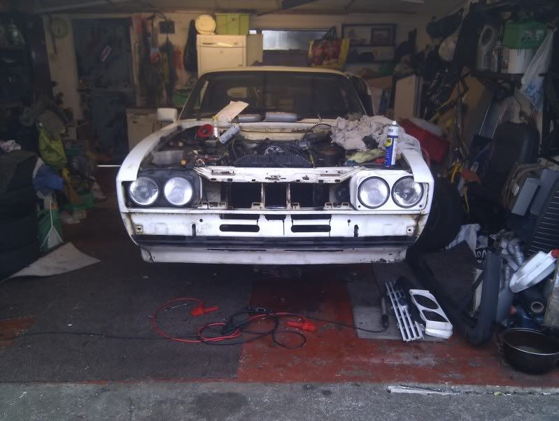

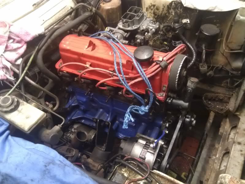

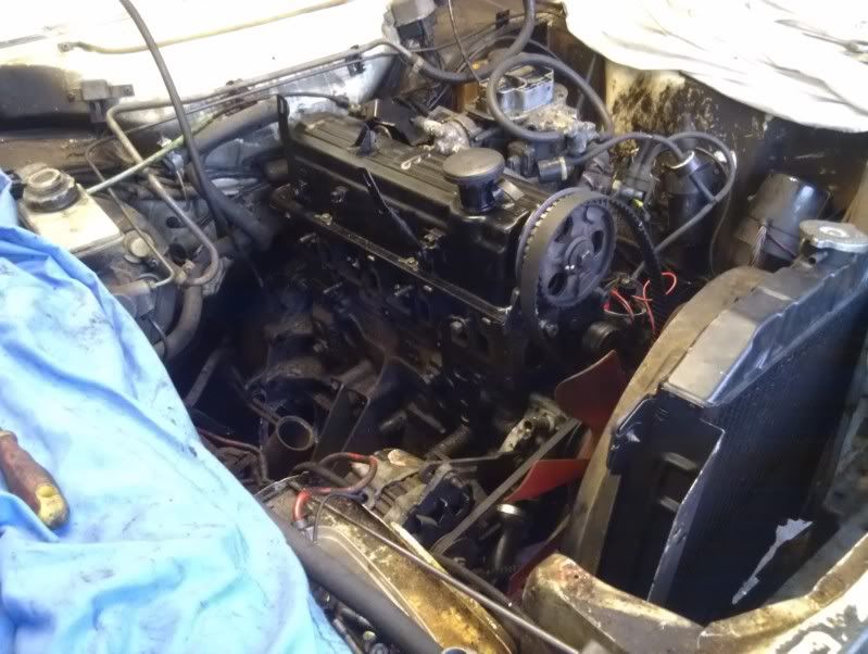

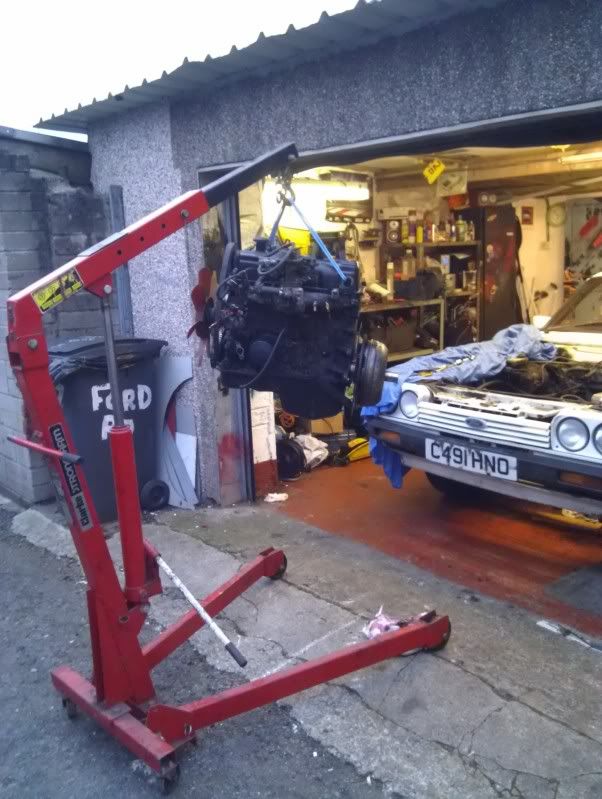

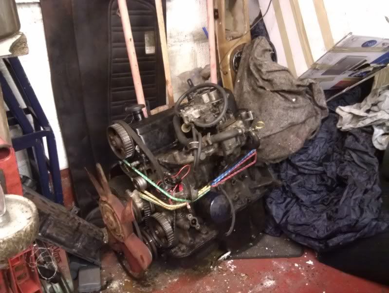

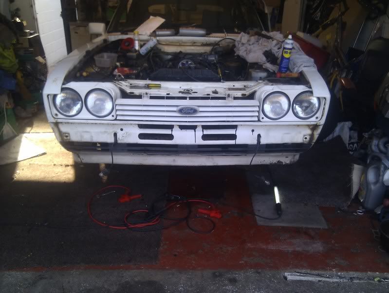

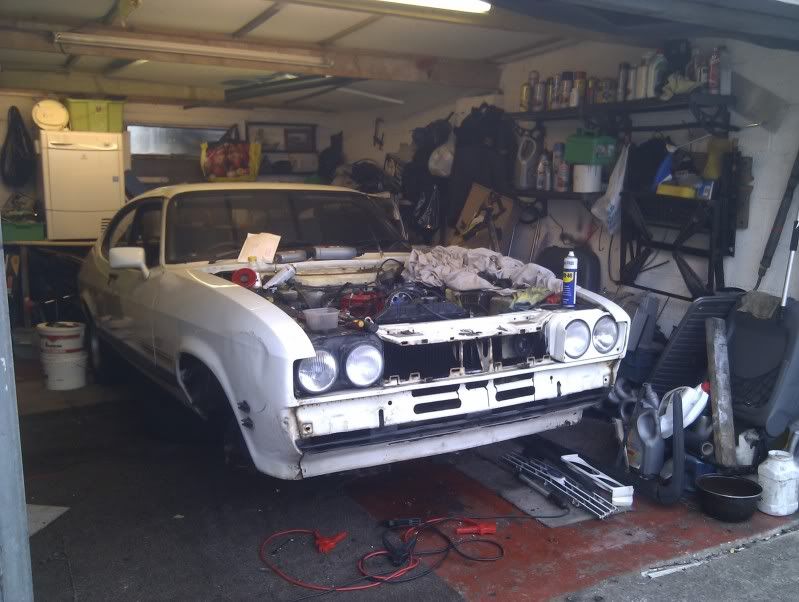

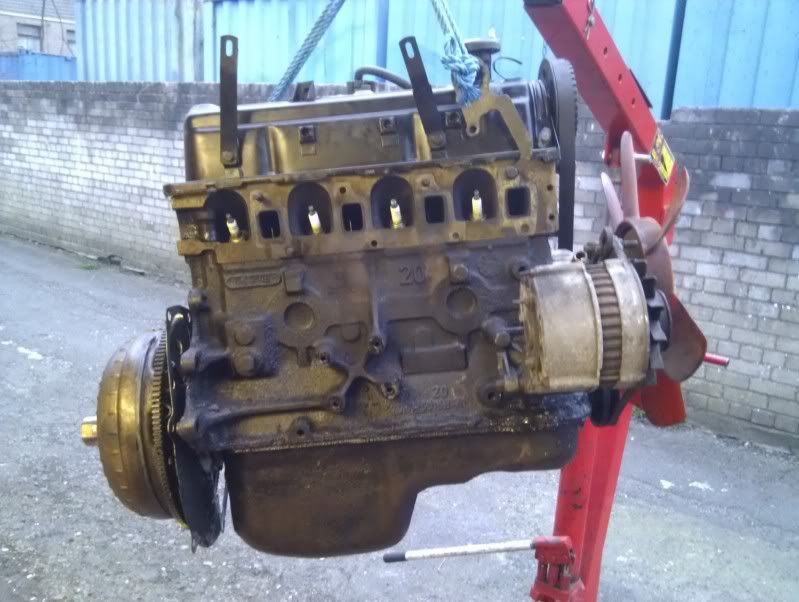

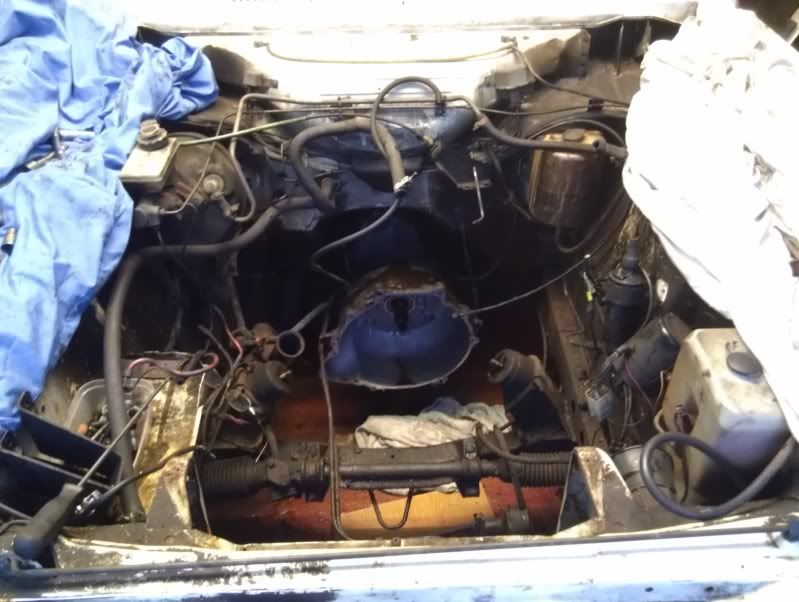

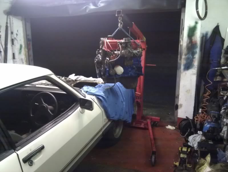

my mate was lending me his hoist yesterday as planned, but when i got down there about to lift it in the boot he changes his mind, useless coon
so after that small delay i sourced another, went and picked it up, and to my delight it fitted in the fiesta
pinto ready to come out, only 2 engine mount bolts securing it
parts in back seat
short while later

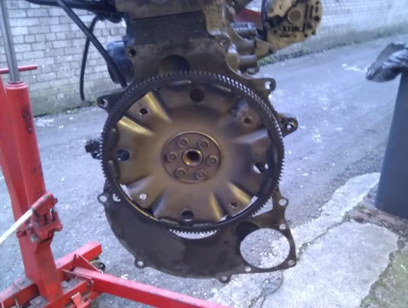

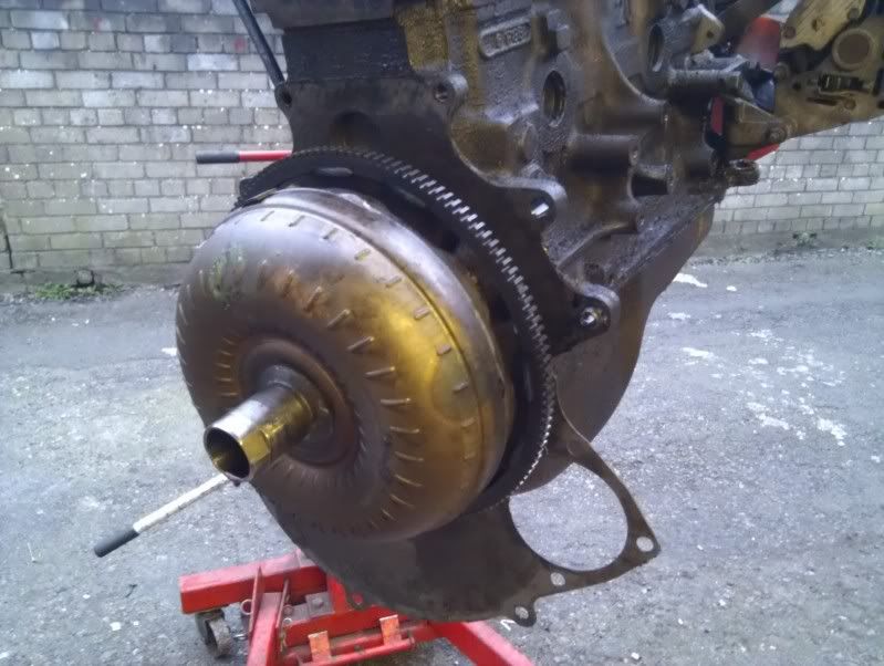

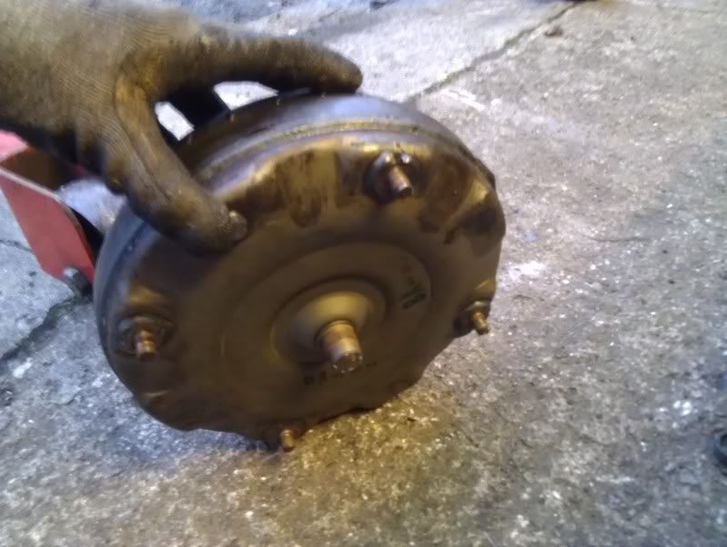

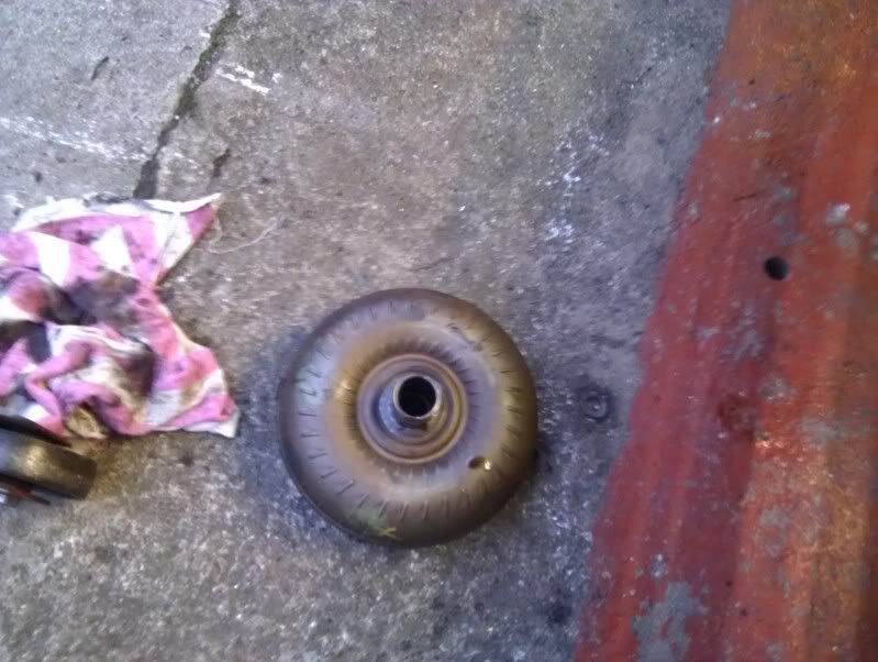

and what the f**k this thing is
so weird looking, a "torsion transfer device"
first time seeing one of these before, looked a bit different in the college videos

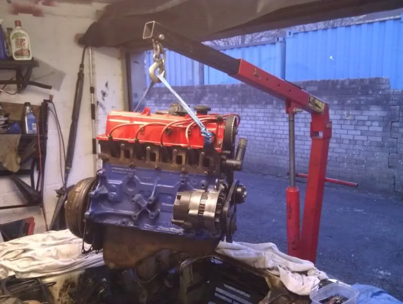

so unbolted it, 5 bolts behind the "flywheel"
took the alternator off and stowed the engine in the corner, ill come back to it later to strip it down
lifted the new engine up and packed up for tonight

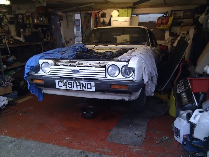

only got the hoist for a few days so tomorrow ill be cleaning the bay, as its full of gunky black s**t
and swapping a few things over eg the automatic setup, got a new fuel pump for it, also the electronic ignition

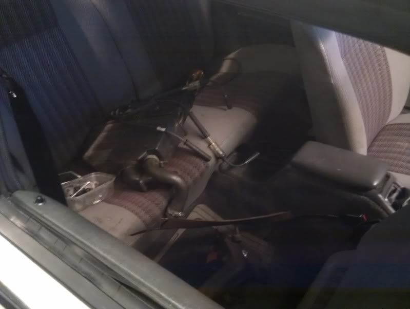

parts in back seat
short while later

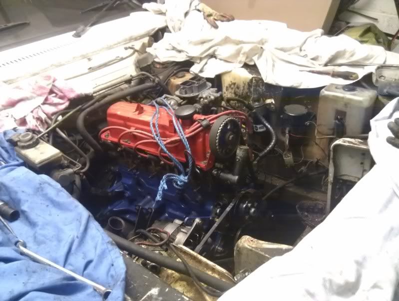

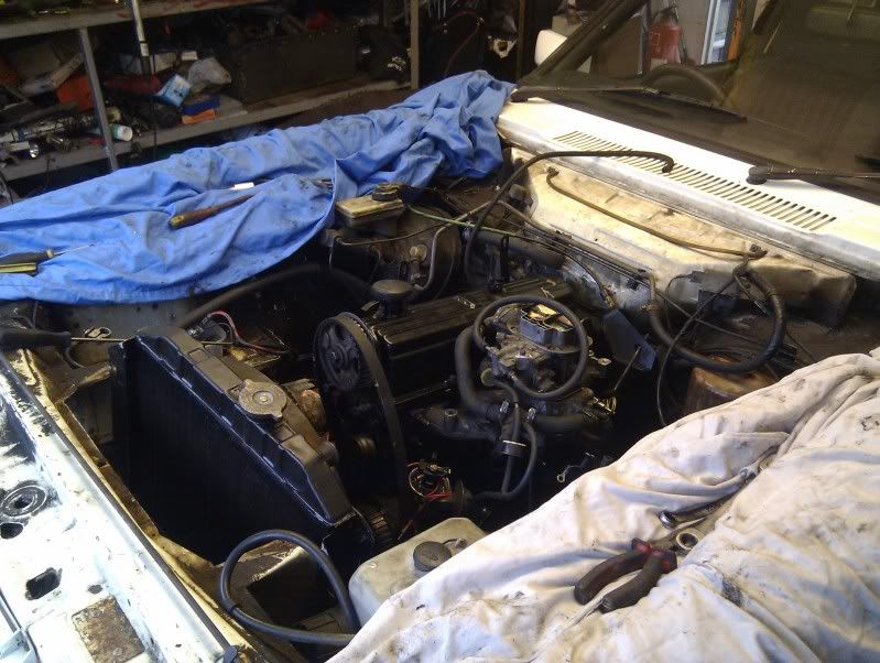

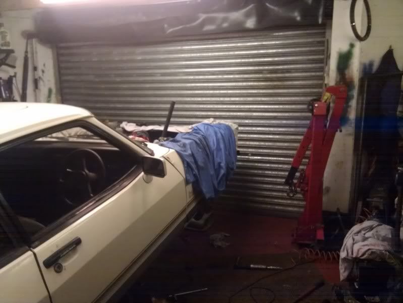

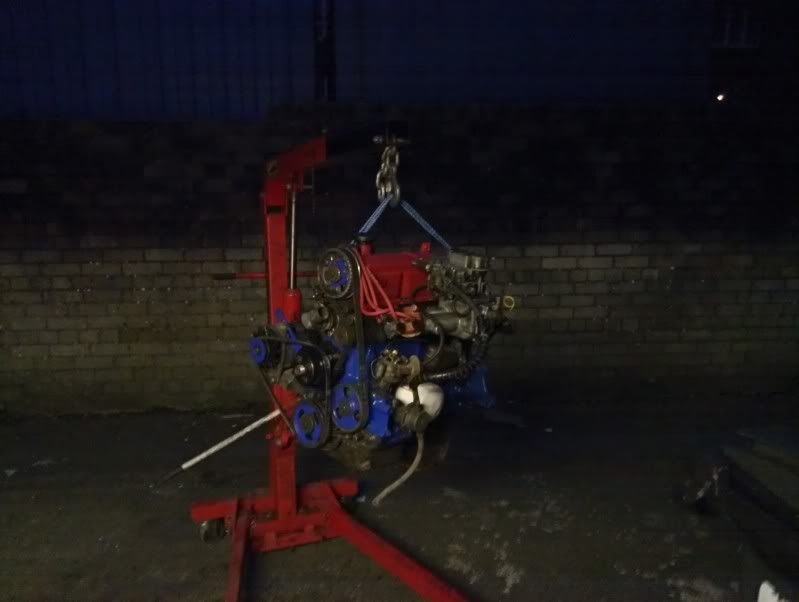

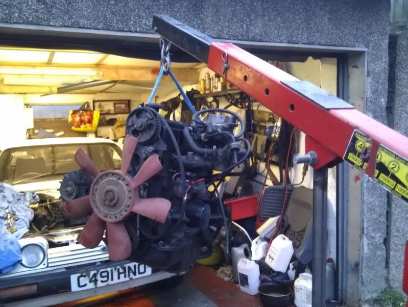

well got stuff swapped over and new engine in, finally after faffing about with the silly torque converter for ages, as it wouldnt line up fully with the gearbox input shaft
anyway its a big thanks to W P E on old skool ford for recommending that i take the engine back out, take the converter off and slot it on the shaft, then position the engine and using the starter motor hole do each of the 4 bolts up that secure flywheel to the converter, worked a treat so thanks man!
hes got the patience of a saint and stuck through my phone calls a few times now
so bolted the gearbox to the block and both engine mounts are on and tight, the hoist needs to go back tomorrow as ive already had it 4 days and the garage is busy!
tomorrows jobs are some plumbing, wire refitting and bolt the exhaust back on, not far from firing up!
pics to complement
and in
comments welcome!
pics to complement
and in
comments welcome!

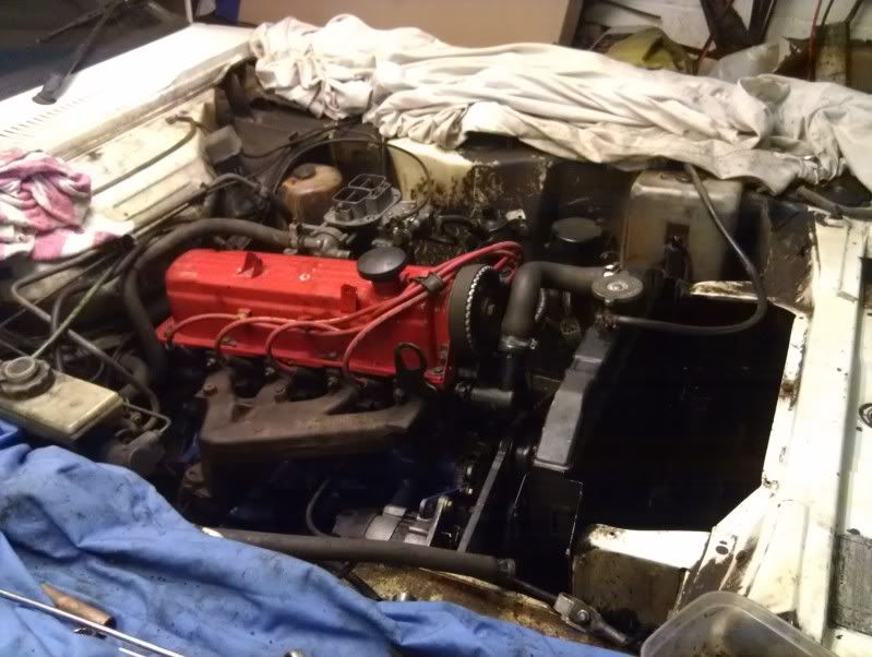

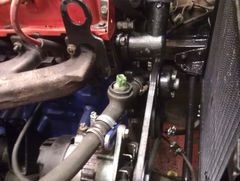

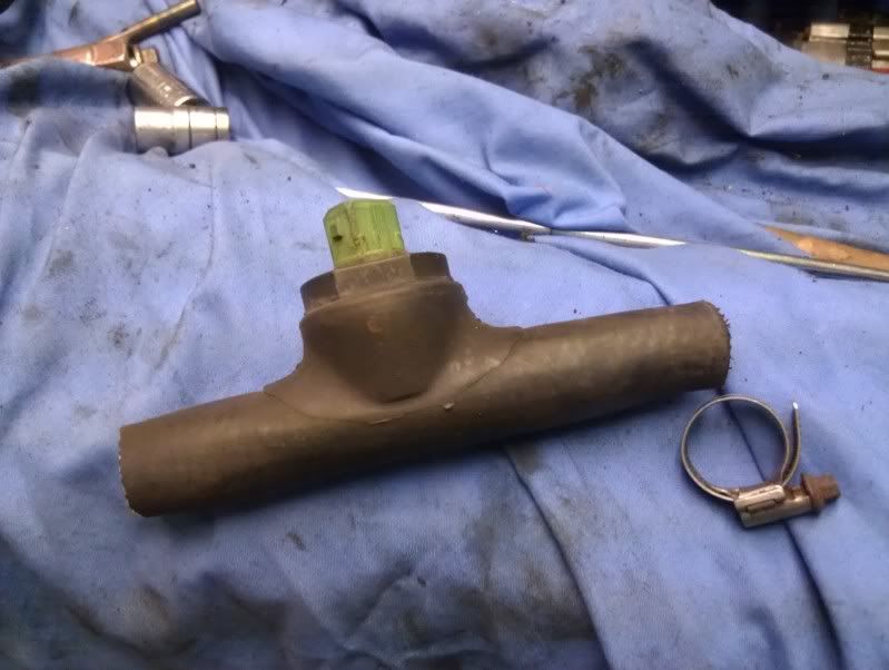

well started to plumb things in, got more done than i planned
since i lost to much fluid
made a start on the electric fan conversion, whether it saves 3 bhp or not i want a nice quite and uncluttered engine bay, so nice efficient electric fan
got this inline switch from a mk4 fiesta with a 1.3 hcs

The thing on the flywheel is a torque converter..
So have you re-fitted the Auto box with the new engine?
Wikipedia wrote:In modern usage, a torque converter is generally a type of hydrodynamic fluid coupling that is used to transfer rotating power from a prime mover, such as an internal combustion engine or electric motor, to a rotating driven load. The torque converter normally takes the place of a mechanical clutch in a vehicle with an automatic transmission, allowing the load to be separated from the power source. It is usually located between the engine's flywheel and the transmission.
The key characteristic of a torque converter is its ability to multiply torque when there is a substantial difference between input and output rotational speed, thus providing the equivalent of a reduction gear. Some of these devices are also equipped with a temporary locking mechanism which rigidly binds the engine to the transmission when their speeds are nearly equal, to avoid slippage and a resulting loss of efficiency.

i know what it is lol ta
yea still a auto, dispite my best efforts, but once its mine a manual conversion wont be far off, should be simple enough

Apologies, from your post I didn't think you knew what it was.
Also didn't realise this wasn't your car, so fair enough.

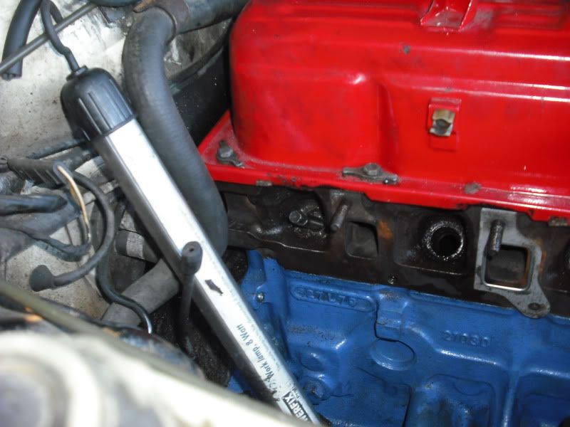

the spark plug is still stuck in the head atm, my old man screwed a "easy out" into it, but ive not been down to extract it yet, guilty to this nice weather we've been having lately lol, no hurry with it but would be nice to have it running

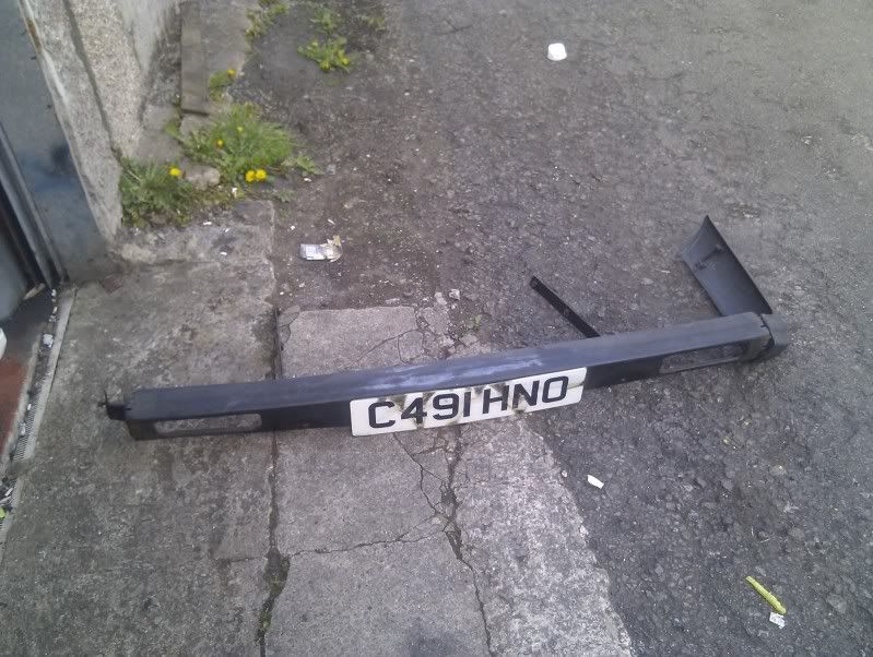

seen bits of rust spots behind the front bumper earlier so ill take it off and clean it up soon

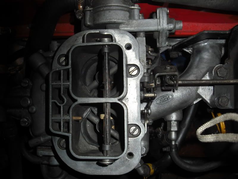

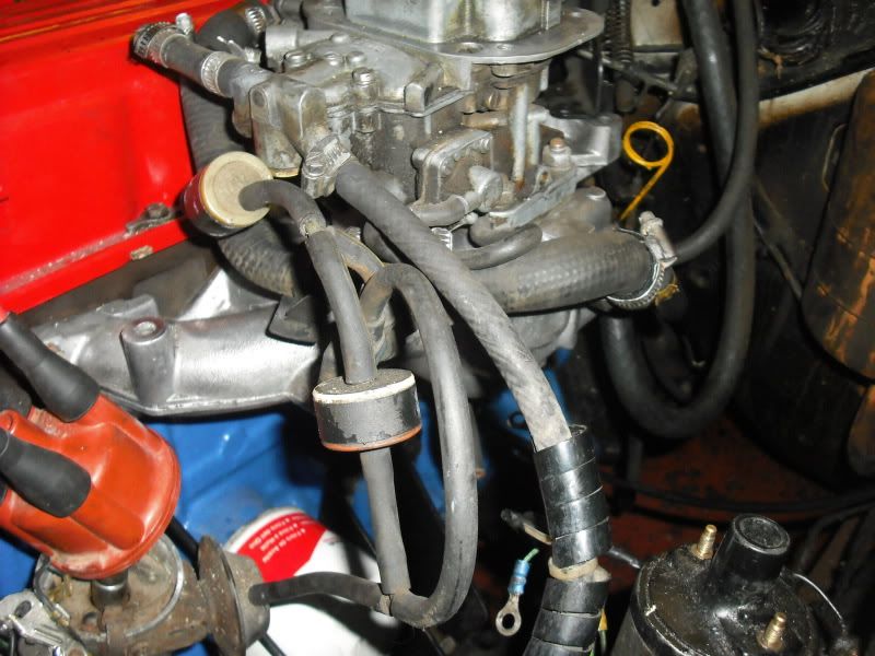

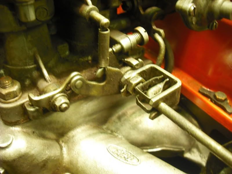

just realised i missed the last update

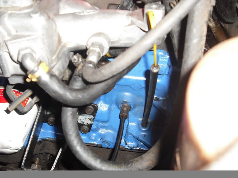

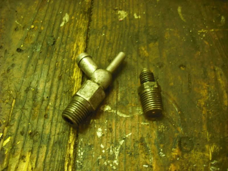

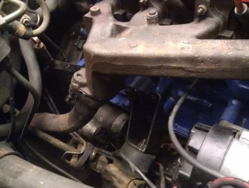

the new engine had different fittings on the inlet manifold so certain ones were swapped with the old engine
also this set of vacuum pipes were fitted from the old, no idea what they do but probs best keep them
as the engine was in a stock car and obviously refinement and comfort werent an issue for that
problem with the throttle linkage, the connector was backwards on the new carb, i unbolted it and turned it around but the second venturi doesnt open fully at full throttle, so might need to swap the carbs over, this one doesnt have the auto choke butterflies either
pic of the thread extractor in the plug
more to come soon hopefully

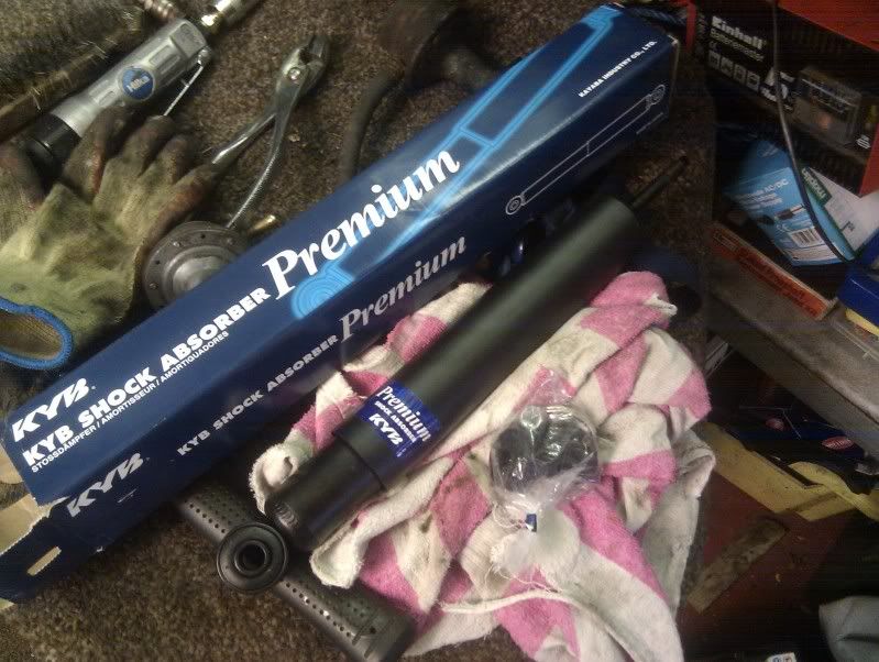

Re: 1986 Capri 2.0 Laser project, new engine fitted but delays
no, im going to recheck the timing as somethings up...
but a new shock come for it
then i took the bumper off
and this is how far i got before being halted by stubborn self tappers
grill and headlight surrounds are going black, bumper is being repainted, and the rust around the front panel is being removed and fresh white paint going on
are you using this as a fan switch to turn the fan on at a certain temp ?
if so you have the wrong sensor. That sensor is a temp sender which sends a reading to the dials on the mk4 fiesta.
You may have to use a mk5 escort top rad hose like i did and use the correct fan switch
Fan switch Finis 7001611 i
lol one too many of them was reposted
cheers clark big help!
i was afraid it was a temp sender, seems a bit small, but couldnt remember or not
i wonder if that proper sensor will fit this ones thread?
- jonyb4
- Posts: 10398
jonyb4 wrote:cheers clark big help!
the one i have which is the same on a Fiesta rs turbo has a much bigger thread.

TBH a fan switch is a fan switch is a fan switch. I'd just go down the factors and see what they have to suit that thread, iirc most fan switches come on at about 95 centigrade
Nothing to see here...
- andymac
- Elite Pie Master
- Posts: 11041
- Joined: Mon Jun 11, 2001 1:00 am
- Your car: Your car: Your car: Your car:
good idea ill take that sensor down with me and see what they got
think its around 90 yea, i know you can get race ones that kick in about 80 instead
