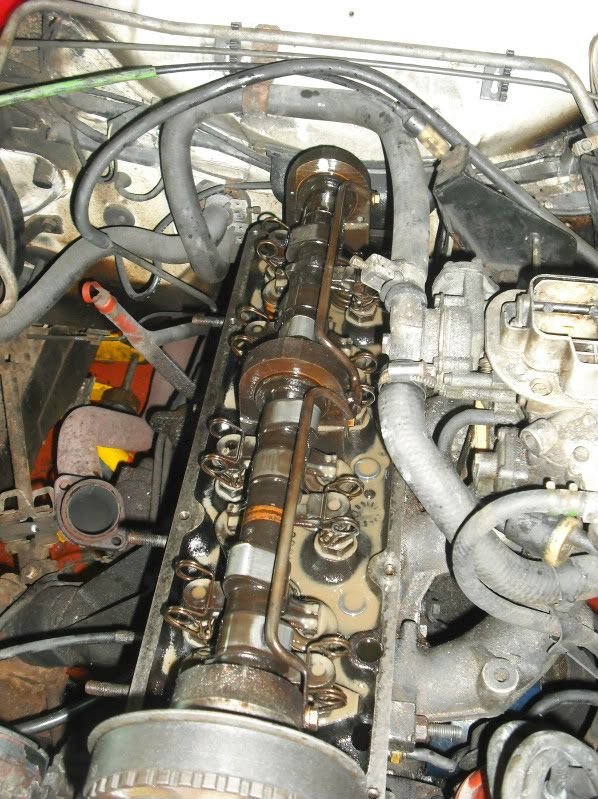

Re: 1986 Capri 2.0 Laser project, Mk1 update!!
you can adjust them on the bench, in a way its alot easier, because you can actually see that the valves are open
valves open valves to adjust
1ex and 4in 6in and 7ex
6in and 7ex 1ex and 4in
2in and 5ex 3ex and 8in
3ex and 8in 2in and 5ex
inlet is 0.20mm exhaust is 0.25mm
you want to just feel the gauge touching as it slides between lobe and follower i wouldnt say feeling it nipp, you want to be able to slide the feeler gauge in with out forcing it or tugging on it to get it back out
i would also once you think youve done them wind the cam round a couple of times and then recheck them
and just watch as youre locking off the 2 locking nuts (that your not actually adjusting the gap again as your nipping them together)

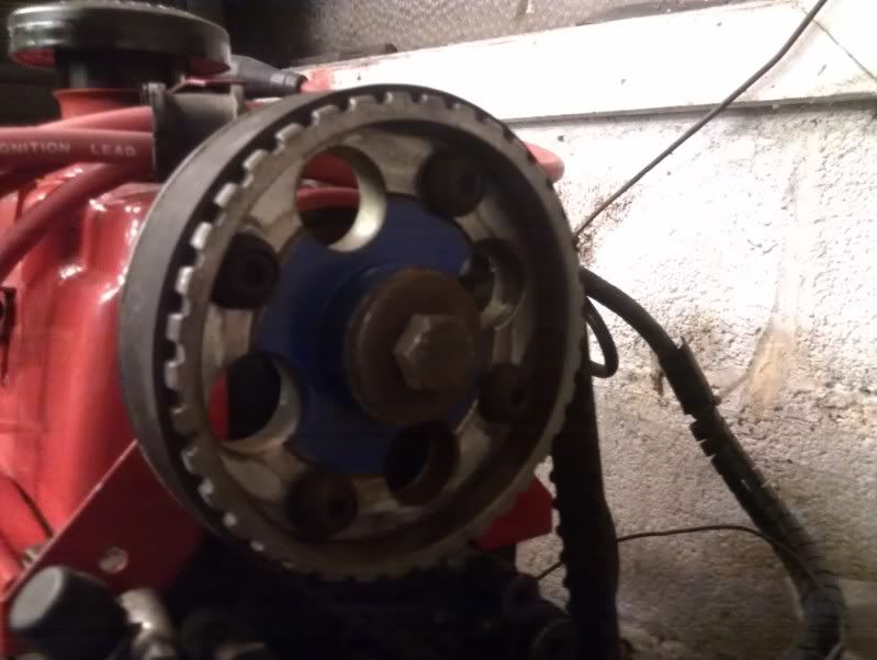

firing order is 1342, timing wants to be 8 degrees BTDC,
take the cam belt off the top/cam pulley
look at the bottom pulley there is a series of marks/grooves, the biggest groove is TDC, line this up with the mark/pointer which is fixed (just under bottom hose area i think) youll see it though)
now take number 1 plug out and check that the piston is at the top, because these engines can be 180 degrees out.
go to dizzy take off the cap rotor arm needs to be pointing to where number 1 plug lead fits, to adjust this if its wrong, loosen the 13mm bolt next to the dizzy and turn dizzy body untill it is in place (some dizzys do have a groove in the dizzy body for number 1)
notice the wheel which is nearest the dizzy which the cam belt fits to will turn, be carefull to keep this in place when it comes to refitting the belt or youll move the dizzy.
now the cam behind the cam wheel you should have a plate which went onits keyed so it only goes on one way, it also has a pointer on it, look through your cam wheel you will see this pointer, turn the cam pully (still without the belt on) so the pointer is at the bottom pointing up, now you should see the pointer pointing to a dimple/mark on the head behind it.
now with out disturbing any of these marks and with(obviously) the cam tensioner loose/out of the way carefully fit the belt adjust the tensioner
mark the TDC pointer and 8 with white tipex (the marks on bottom pulley go up in 2s, 1st mark is TDC then 2 4 6 8 10 12 )
plug a timing strobe light in line with number 1 plug lead, start the car it will start but may run a bit strange as its only TDC, point the strobe light to bottom pully turn the dizzy untill 8 lines up with the pointer
good luck. did you get the valve clearances set ok

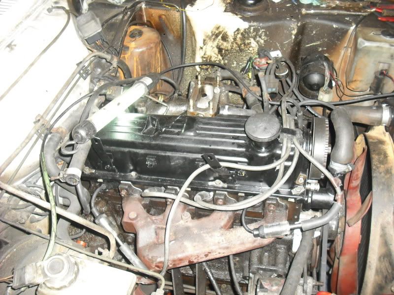

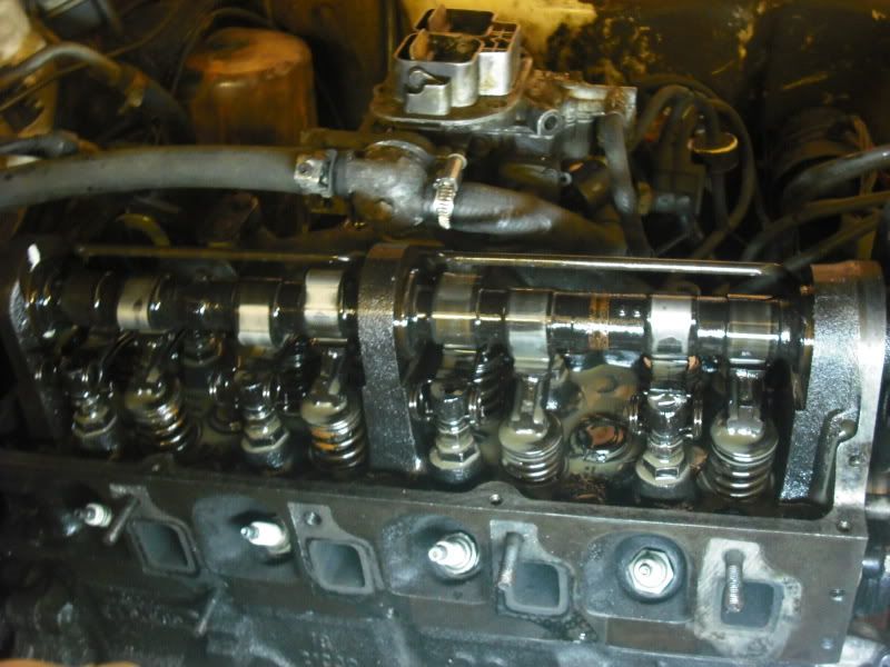

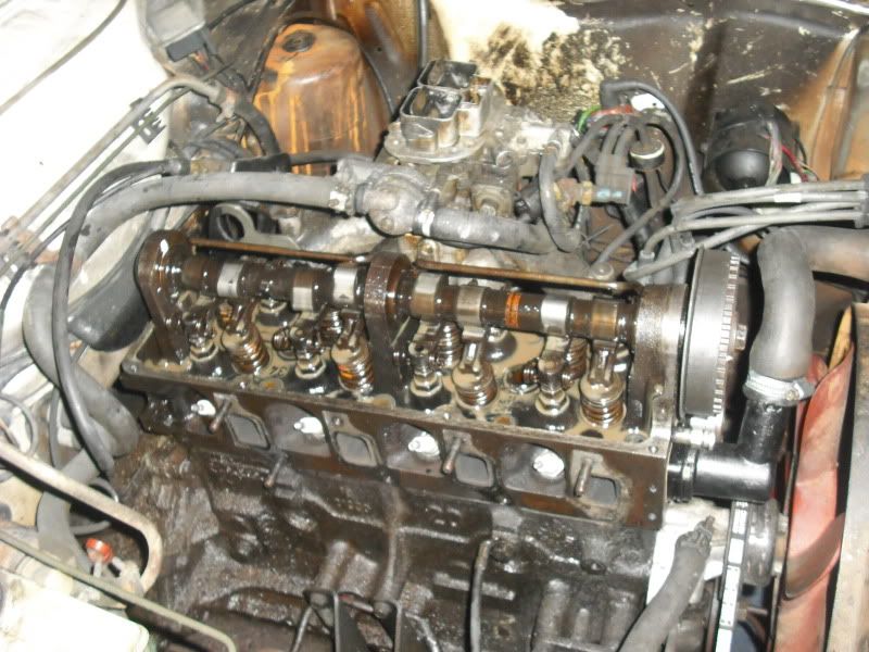

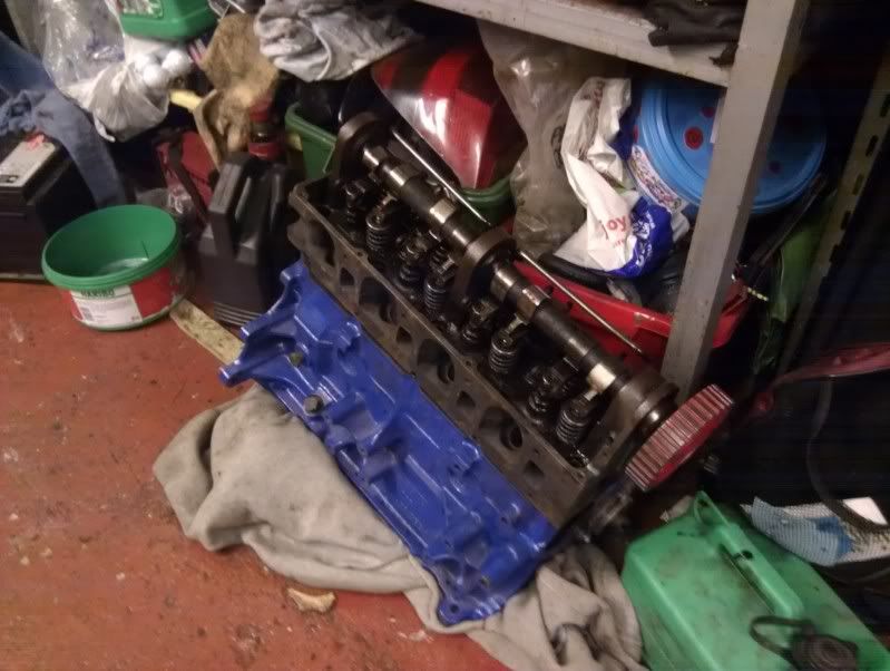

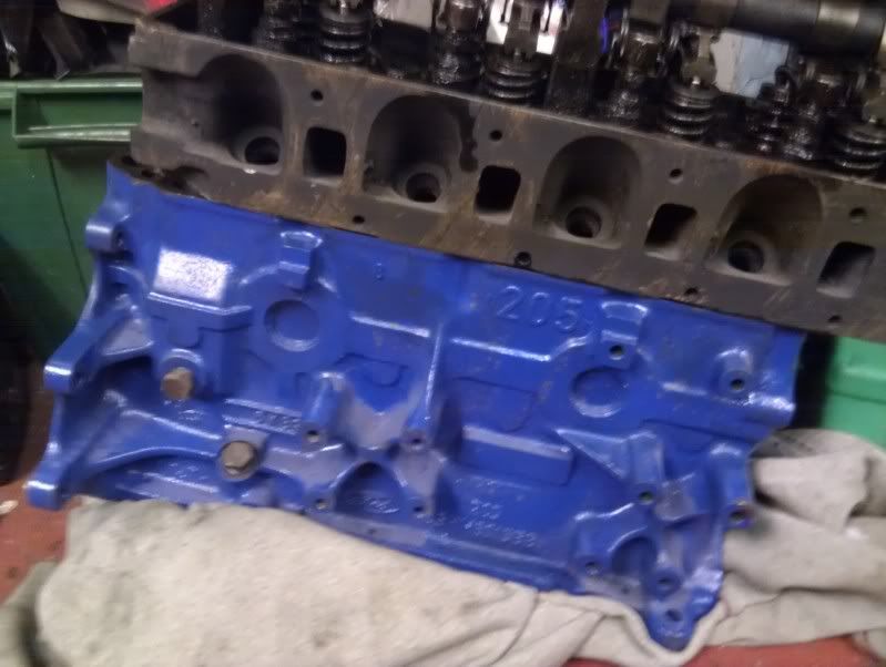

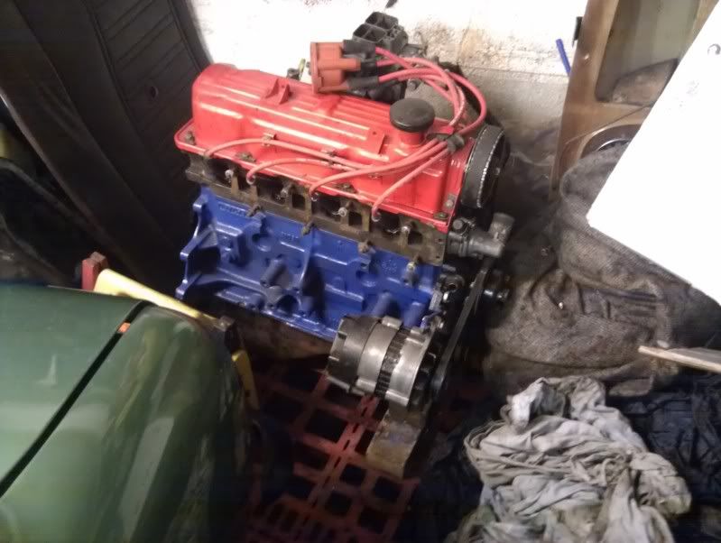

Update
got each of the tappets fitted and adjusted to 0.025mm gap on the exhaust, 0.020mm on the inlet
fitting the thermostat
cleaned the bolts up
fitted the head and gasket, the 10 bolts in place ready for torquing sequence
cam cover gasket
cam cover mucky old bolts...
... were given a new lease of life
fitted
new exhaust gaskets
on... new air ratchet makes such light work of nuts and bolts
and will set them all to 50lbs/ft too

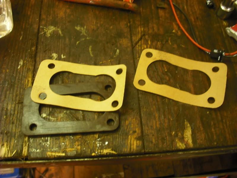

inlet gasket... notice the water inlet pipe between port 2 and 3?
in my mind its bad design to have water flowing so close to the inlet ports, if a leak happened it could destroy con rods letting water int he chambers
done for last night, got in at 1AM!

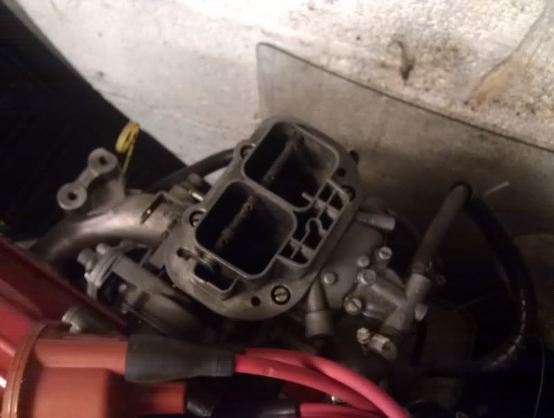

these arrived today, handy quick air line couplings
timed up and all together minus the air box
slight snag, i dont have a clue about distributors, nor how to time them up
im getting spark, but i dont know if its firing at the right time.. doesnt help that the dizzy is loose and turns by hand!
can any one give advice?
i know its fueling, plus ive been pouring petrol down the carb, only managed 1 hickup from it

will re time the belt, get it closer to starting by turning the dizzy and then get my hands on a timing light to get it spot on, after that we will buy a electronic trigger for the dizzy, i dont like the mechanical one in it, they need gapping annually
and the electronic kit only costs £22
almost got it running, it was trying to start
im having someone turn the key, and im twisting the dizzy, but by the time its tried to stat ive already moved the dizzy futher! agh

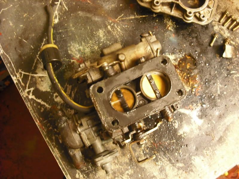

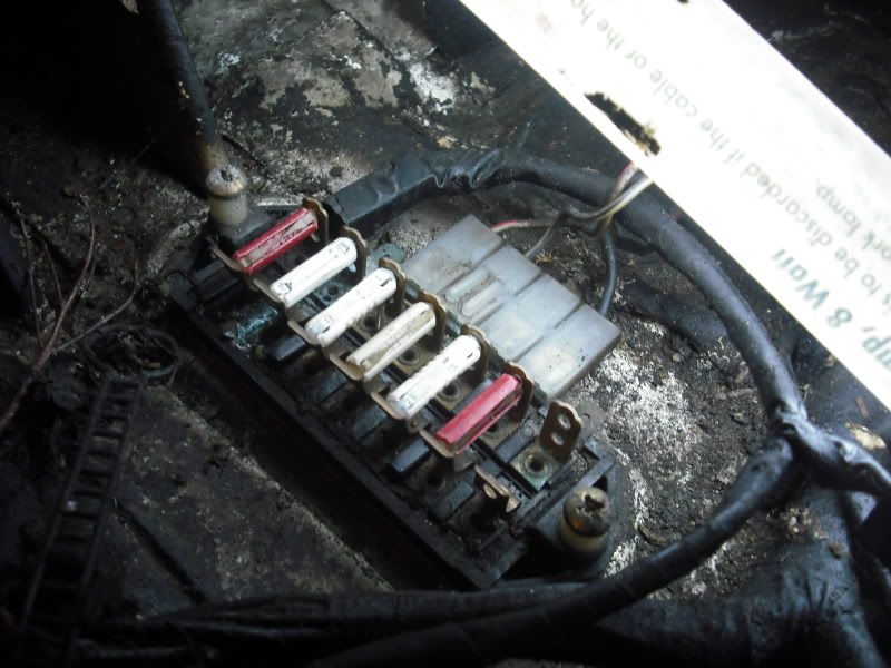

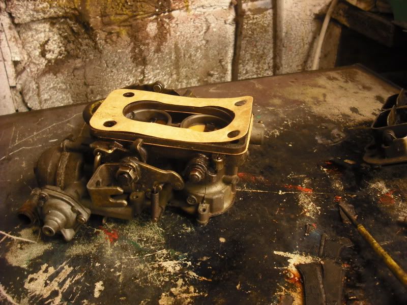

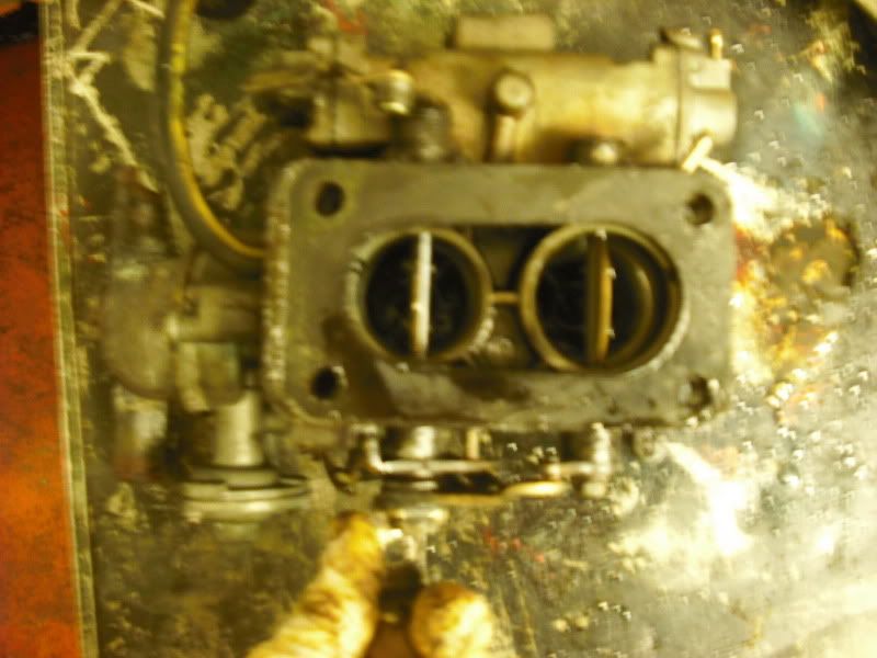

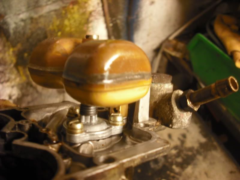

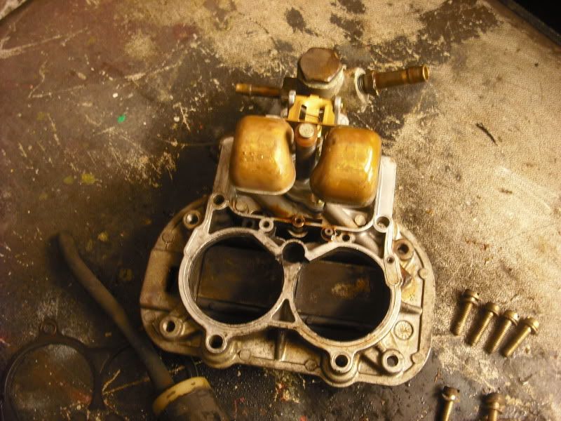

after days of trying to start this engine, im starting to believe it is knackered...
simply will not start
started with being an ignition timing issue, now thats all set up lovely and accurate as possible without it actually running to use the strobe
its not helped, even thought it might be a fuse problem, so had cleaned each terminal and fuse up

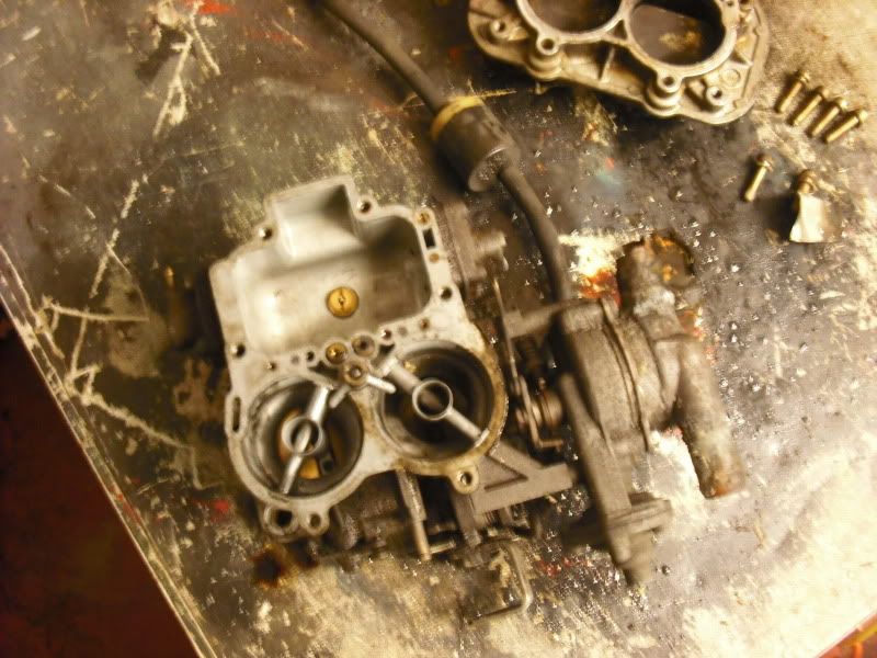

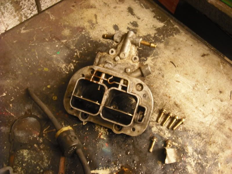

then i figured fuel wasnt reaching the cylinders, so i then took the carb off, checked it used compressed air to clean the jets etc, refitted with cleaned and new gaskets
still wont start
cleaned up using my new air belt sander, can also see my new disc cutter which ill need for sorting the fiesta
gaskets on
so i then had an urge to remove the exhaust manifold and try it. so then it would pop and blow flames, seem as if it wants to start but never actually achieve it
so that passes the exhaust being blocked like i figured at first
i then took the cam cover off, and saw this:
very light brown oil that was only put in fresh 2 days ago...
(car is jacked up on the drivers hence the oil swaying)
now its hardly meant to be that colour!
i serviced my fiesta 2 months ago and thats still got golden oil :?
i presume this is water mixing and if it was running after a while it would turn white and mayonnaise like
so its starting to look grim for this poor pinto!
me and the old man are going to have a capri clued mate roudn to give a second opinion, but we are talking about what engine is going to be replacing this, another pinto? zetec? I4 8v? CVH?
any advice recommendation ors even if you know of an engine for sale, please let me know!

was going to start by saying it wont be a fuse, since its actually turning over and trying to fire
then was going to comment on your carb it looks very clean so cant see that being a problem, plus it would fire up with a slightly knackered carb but just wouldnt run right
youre right no the oil shouldnt be that colour, your heads cracked, it only needs a small hair line crack
options are imo anyway
1, head off take it to a engineering place and ask them to test it this costs about £30
if it comes back confirmed knackered you could just buy another head for your pinto
2, another pinto pref a 2.0 but a 1.6 would also go straight in using your accillories
3, v6 2.8 injection, youd need all the accsesories including gear box prop and fuel tank
4, zetec again youll need all the accsesories dont know what these are for this conversion
5, duratec again with accsesories not sure what they are
cheapest is pinto either head or full motor
pm a man called howierpm on oldskool ford he knows loads about what you need for zetec rear wheel drive conversion
he might even have a pinto or zetec for sale but he can deffinately give you loads of good advice

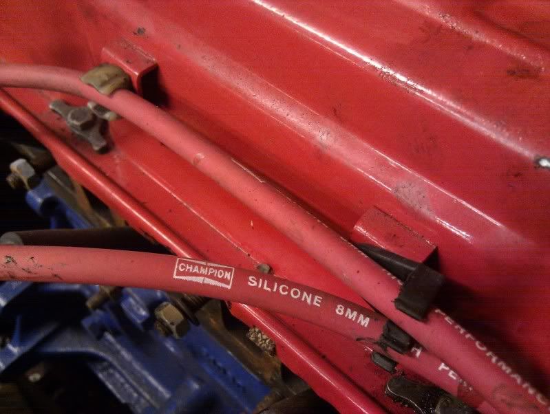

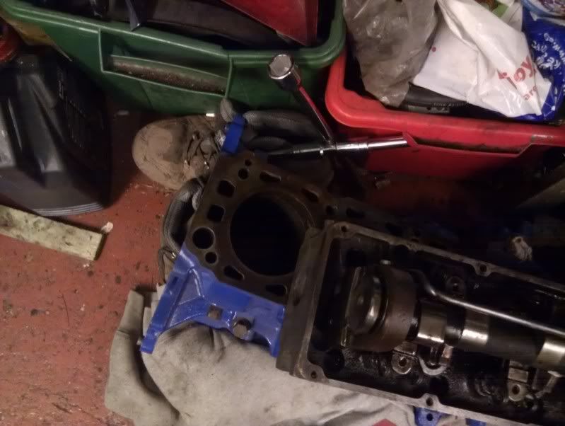

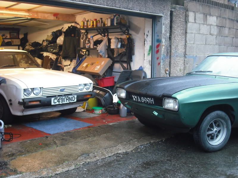

come home from holiday to be greeted by these pair of lovelys
number 1 is in bits, a 205 block and missing its bottom end, and a loose head
the other is a 2.0 non 205 block, has a selection of mods done to it and is ready to go, just needs freeing up after a years sitting
fast road cam, twin 40's i believe, 8mm silicone leads, and ported head (again im not 100% on that)
work will start soon then
fair play tot he old man for finding them, locally for £100, with tons of spares for the 205
