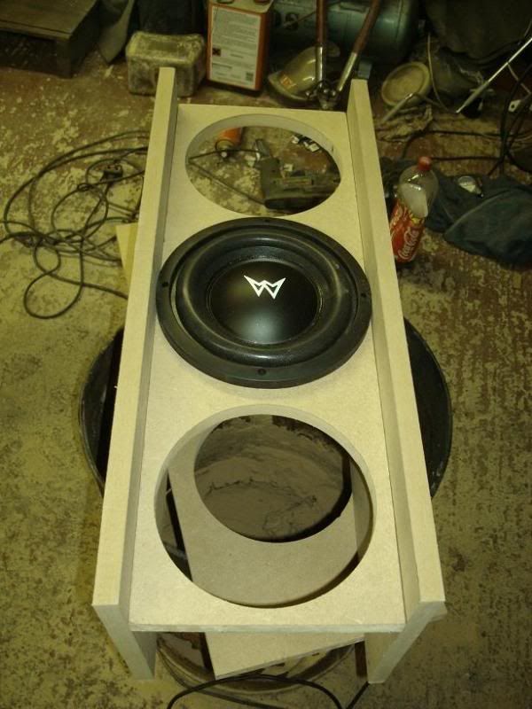

Hey guys, had a customer come in looking to take up no boot space whatsoever, wanted a fair bit of extra bass and wanted it as tight as possible...didnt have to be mega loud...but just nice so when he listens to his Raggae and dubplate, theres enough presence there on the bottom end...
after ummming and ahhh-ing, we decided to build everything into a centre console...the console will also house a custom switch panel for a few of his toys which will be details later on
Plan = 3 Ascendant Audio Assassin 8's, custom enclosure, perspex panel, switch panel...and lot of boom boom boom!

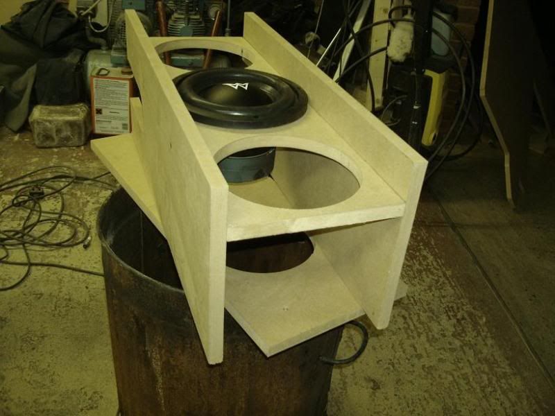

Right, after measurements were taken, it was time to get cutting

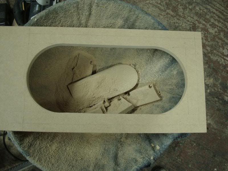

MDF panel cut to size
Marked up ready for panel to be cut out

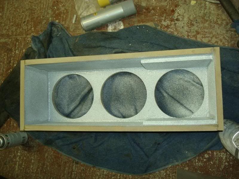

Box built up
Were going OLD SKOOL! LOL
Test fit
You cant see in the pics, but the side panels needed cutting to clear the backrest levers, ill get some better pics of this as the build continues
Just waiting on the perspex panel to arrive...but before thats here, the box will be flocked as its a new trimming material we now do and this is the first customer build we have undertaken with this covering
Box built up

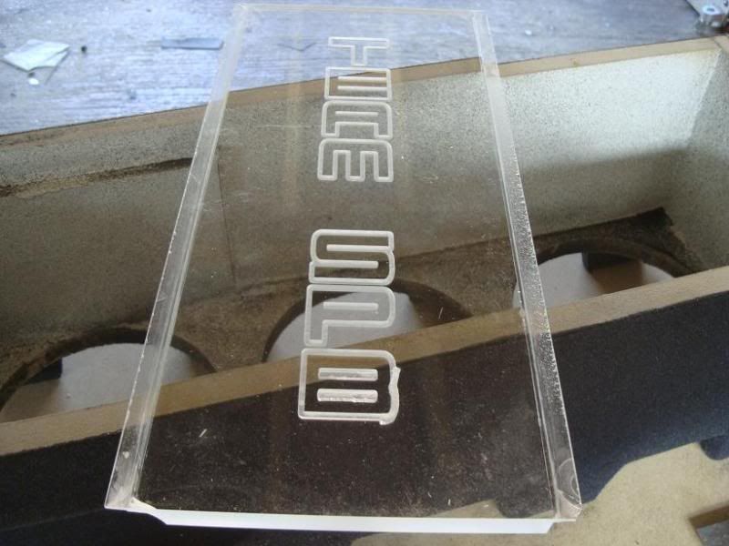

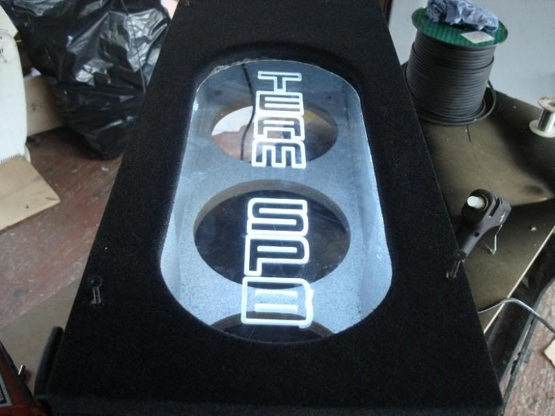

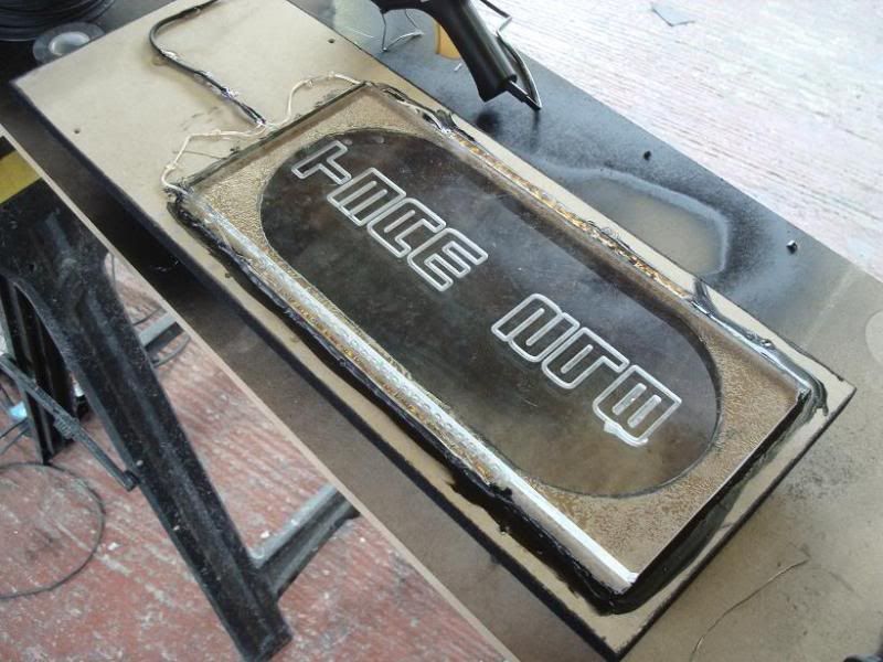

Right, got the perspex through today:
LED's are all fully wired up and work very well!
Tomorrow everything should be dry and ready to go!

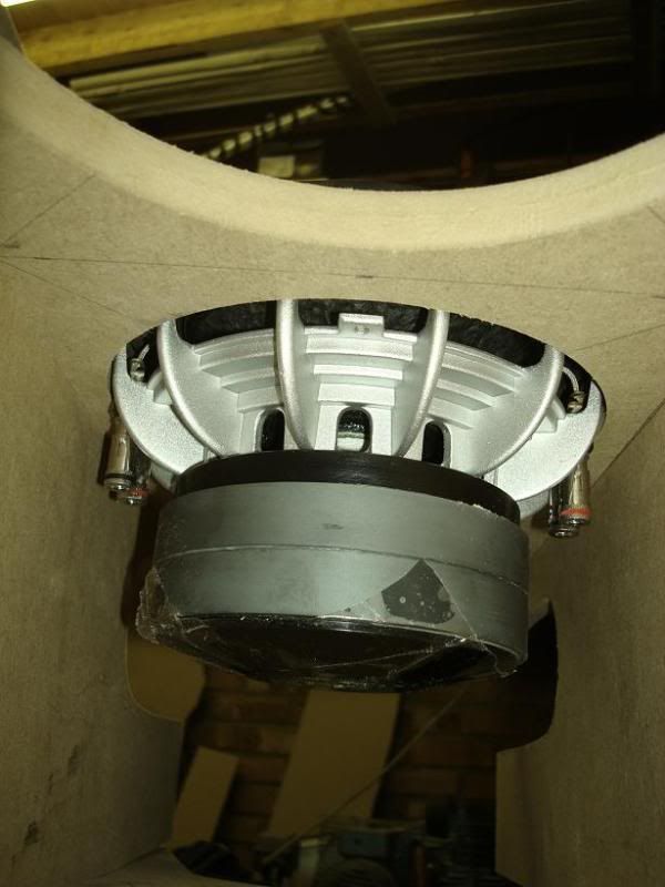

Few pics i didnt put up...
Test fitted an 8 to make sure it goes in as its a tight fit lol
The reason why we had to cut out side slots
testing LED's (yes i know the 'b' has messed up but a replacement is in the process of being sorted
more to come soon!

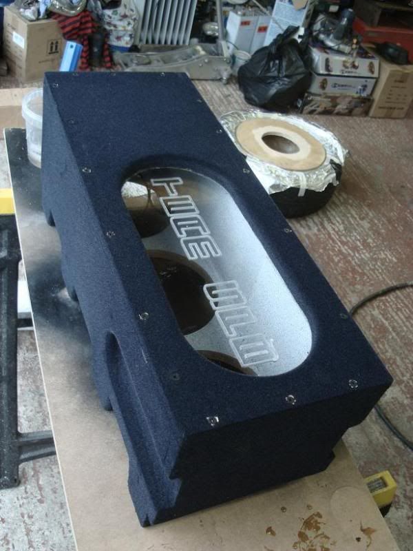

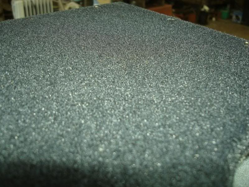

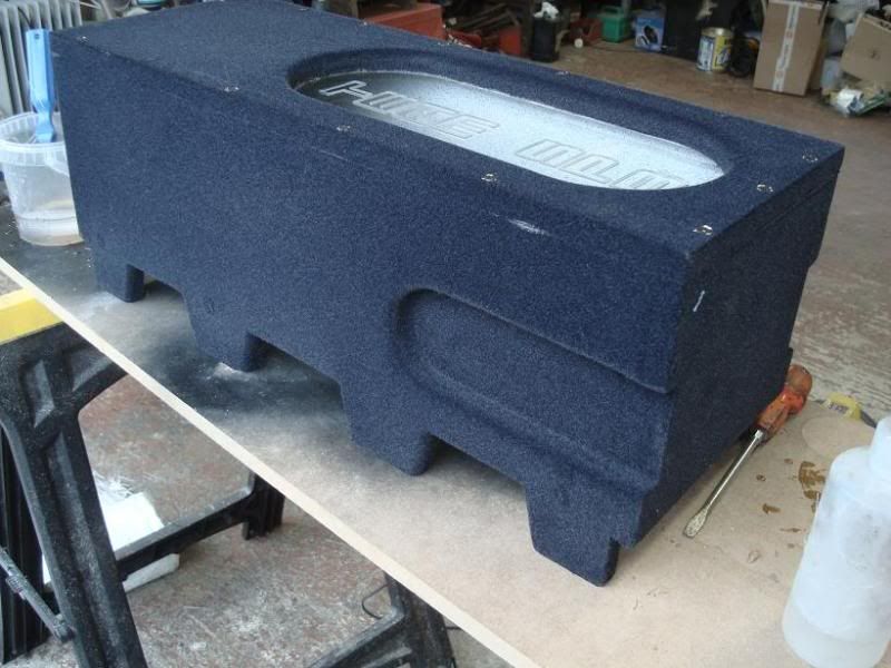

Some pics of the finish...

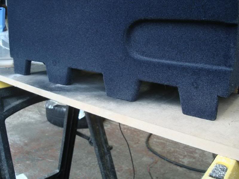

Slots for backrest position
Side slots to help the bass come out as subs are firing down to the floor
You can see the next project with a spare wheel install in the background lol

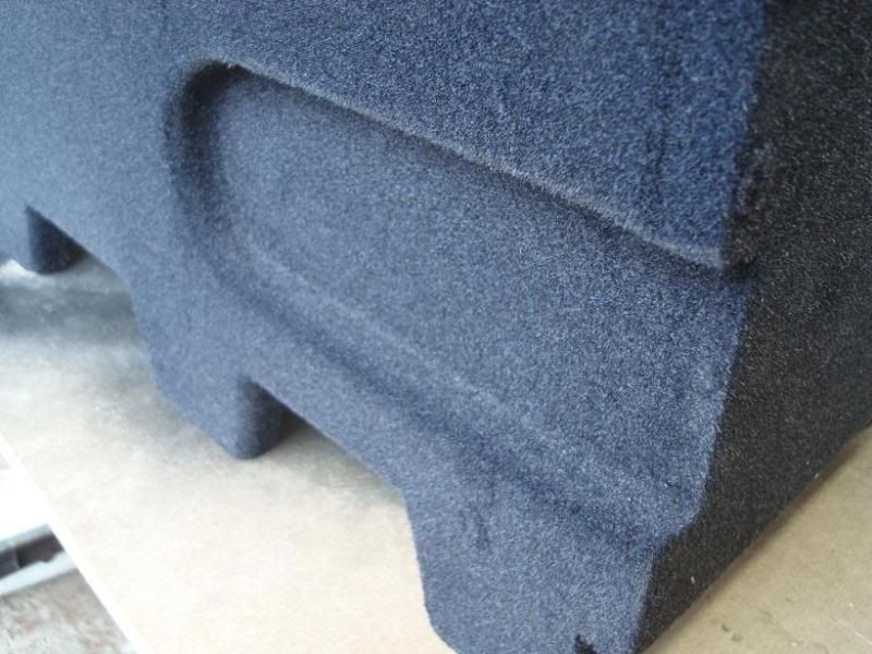

It is actually black..but changes to dark blue in certain light
bassboy

forgot to add...ignore the screws on the top panel, they are only in there while the proper screws are away getting flocked

That looks good! What did you use to stick down the stuff you flocked the box with?
- - Danny Boy -
- Posts: 3845
- Location: Portsmouth
- Your car: Fiesta Si 2.0
Re: Custom Centre console build
Its a strong contact adhesive and the flock is charged on so it always stands on end and uniform
